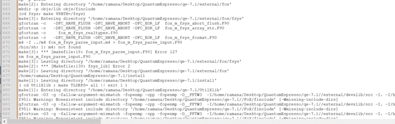

The system at my college died and I did a fresh install of ubuntu and tried to install quantum espresso after installing the required dependancies according to the instructions in the link "https://osuginoissp.wixsite.com/mysite/a-install-quantum-espresso" . But the make all command keeps showing error. I will attach the contents of the terminals in text file

You have to go through these compilation messages from top to bottom and find the first error that occurs. Most, if not all, errors that come after that are probably caused by the first error. Can you find the first error in the log?

yes its on the 672nd line, after the make all command is executed but not sure what it means or how to fix it. i tried to search online but couldn't find anything.

Also, are you concerned at all about the many warnings like this? "Warning: Nonexistent include directory"

What is Error 127?
I think you're going to have to backtrack through your make report to figure it out. It's very long and of little use for diagnostics on its own.
The last error says it can't find some .mod files and errored out with a fatal message. Use those .mod names to backtrack and see if they failed to compile or link previously in the make report.
There's a warning just above the fatal one that say some include directory is missing. This may mean there's more code to be added or that some earlier step failed to create the include directory.
Just before error 127, it says 'm4 not found', which is a common package that should be installed. Error 127 is usually 'file not found' or something similar.

Good catch, so the m4 macro processor may be customizing/building some of the needed files based on the OS you are running on.

I check and found that m4 was not installed and after installing it the make all command ran without error. thank you for your help.
