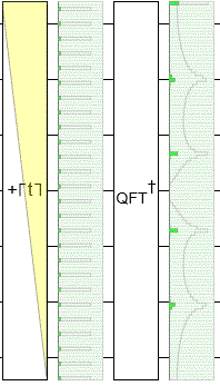

In Nielsen and Chuang p.223 we have the following situation:
$$\frac{1}{2^t} \sum\limits_{k,l=0}^{2^t-1} e^{\frac{-2\pi i k l}{2^t}} e^{2 \pi i \varphi k} |l\rangle$$
Which results from applying the inverse quantum Fourier transform to state ##\frac{1}{2^{t/2}} \sum\limits_{k=0}^{2^t-1} e^{-2\pi i \varphi k} |l\rangle##. We have more or less a sum over the basis states ##|l\rangle##. This is clear so far.
Next, the following new notation is then introduced ##|(b+l)(\text{mod } 2^t)\rangle##. Were we know from ##b## that it is an integer in the range from ##0## to ##2^t -1##.
What does this ##b+l## mean exactly, how is this to interpret? Why does one not leave it with the basic state ##|l\rangle##?
You have computational basis states ##|0\rangle##, ##|1\rangle##, ##|2\rangle##, etc.
Instead of writing ##|2\rangle## you could write ##|1+1\rangle## because ##1+1=2##.
Instead of writing ##|2\rangle## you could write ##|3+7 \pmod{8}\rangle## because ##(3+7) \bmod 8 = 2##.
Get the idea? From that you can see that looking at ##\sum_\ell |b+\ell \pmod{N}\rangle## instead of ##\sum_\ell |\ell\rangle## is shifting the labels of the states over by some fixed offset ##b##, wrapping around just before you get to ##|N\rangle##.

Ah, it's not a description of a solution it's a description of a problem. When you have a register x that contains a uniform superposition and you measure f(x), where f is a periodic function period p, you are left with a superposition where every p'th state is present... with some uncontrollable offset b. The book is then going to show that when you take the Fourier transform of this register, the offset b becomes purely phase information; the magnitudes of the amplitudes of the superposition don't depend on b. Measuring in the frequency basis avoids the unknown offset problem.
Image is from here: https://algassert.com/post/1718

So let me understand this correctly. So with the offset ##b## in ##l+b## you are anticipating something at the point (anticipating shor algorithm)? I find problematic that at the point it is not pointed out where the offset comes from and why it occurs. Mathematically this is equivalent whether I write ##\sum_\ell |\ell\rangle## or ##\sum_\ell |b+\ell \pmod{N}\rangle##, the index remains the same. I can only explain this in such a way that one would like to measure ideally ##l##, but this does not always go so that one then "measures around" ##l## with a distance of ##b##.
I take from your article that this offset is caused by the sampling and can be dismissed/interpreted quasi as noise. And exactly this noise is picked up by considering this as offset?! This is a good explanation, which I would have liked to see in the Nielsen as well.
