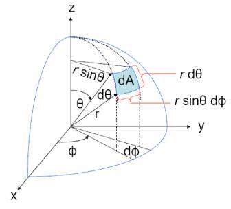

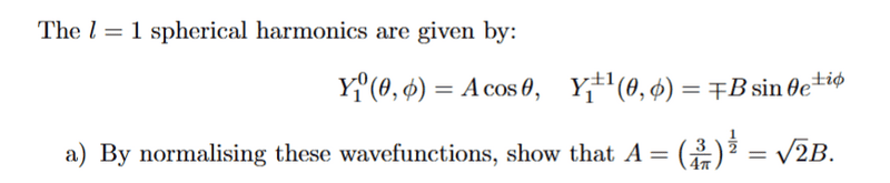

In the solutions, I must integrate ##Y_1^0 Y_1^{\pm 1}##. But my concern is when it states that the differential element (I think area?) is ##d\theta d\phi##. I know that as
then ##dA=r^2 \sin \theta d\theta d\phi##. But the solution only states ##\sin \theta d\theta d\phi##. Why is this? Also, the units are not even area, so I have some problems with what this differential element is.
Is not the differential of area but the solid angle. I am not sure what you want to understand here, the spherical harmonics only are in radial coordinates and pertain only to the angular part.
Do that and you should get zero, and you will get zero if you do the integration correctly. They are orthogonal functions, after all. What you need to integrate are ##\left(Y_1^0\right)^2## and ##Y_1^{\pm1}\,\left(Y_1^{\pm1}\right)^\ast##.

You are integrating over the surface of the unit sphere, so ##r=1##.

In conventional spherical coordinates an area element ##dA## on the surface of a sphere of radius ##r## is the product of two arc lengths, ##ds_{\theta}=r~d\theta## and ##ds_{\phi}=r\sin\!\theta~d\phi## so that $$dA=ds_{\theta}\times ds_{\phi}=r^2~\sin\!\theta d\theta~d\phi.$$By definition this area subtends a solid angle $$d\Omega=\frac{dA}{r^2}=\sin\!\theta d\theta~d\phi.$$ The radius is irrelevant.
The orthonormality condition for the spherical harmonics is $$\int Y^*_{l'm'}(\theta,\phi)Y_{lm}(\theta,\phi)~d\Omega=\int_0^{2\pi}d\phi\int_0^{\pi}Y^*_{l'm'}(\theta,\phi)Y_{lm}(\theta,\phi)\sin\!\theta d\theta=\delta_{ll'}\delta_{mm'}.$$There is no ##r##.
