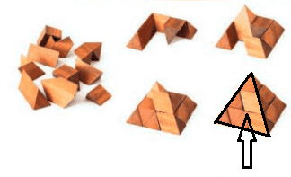

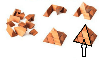

Lnewqban said:
What do you call the front face?
This face:
Lnewqban said:
For any of those cases, each part would also have to have unequal values of bpart and hpart, which makes me suppose that such characteristic could be used as a clue for choosing the vertical or horizontal orientation of the part.
Judging by the picture, at least all the parts in one level or layer seem to need to measure the same hpart.
What do you mean by "part"? Do you mean the faces? Or do you mean the 10 smaller pieces the puzzle consists of?
murshid_islam said:

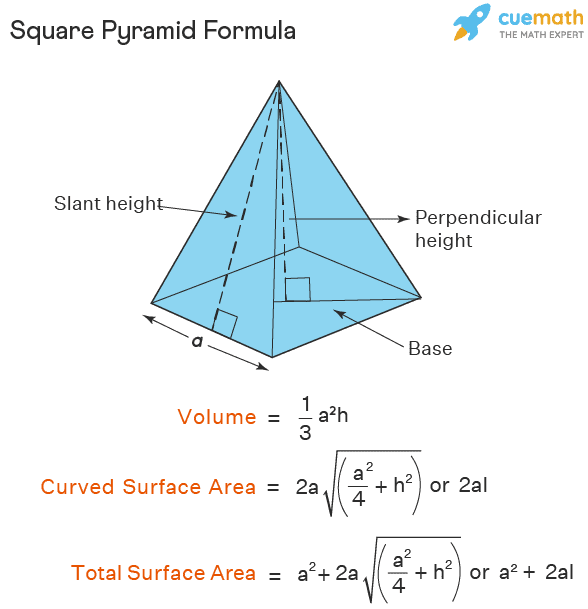

Then, that face can’t be vertical.
Note that the height of that face is called slant in the diagram of post #2.
Also note that it is the perpendicular height the “h” computed in the shown equation of the volume.

This face:
Yes, I agree. That face looks to be vertical. Also, the face that's viewable in that same image, and which is adjacent to indicated face also looks to me to be vertical. These two faces share a common edge, which is the altitude of the pyramid. Not only are these two faces perpendicular to each other, they both are perpendicular to the square base and furthermore, each is perpendicular to the oblique face it intersects along an edge. It seems to me that having all these surfaces with these perpendicular relationships is needed because, the same pieces go together to form a cube.
Up to this point, there is no reason to set ##h=b=3\,\rm{cm}##. But having ##h=b=3\,\rm{cm}## makes the numbers work out nicely. However, there is an additional interesting feature of such a square oblique pyramid for which ##h=b##. If we take three such pyramid's, we can place them together in such a way that they form a cube. This cube has a volume of ##h^3## or equivalently ##b^3## or in or our case, a volume of ##3^3=27\,\rm{cm}^3##.
