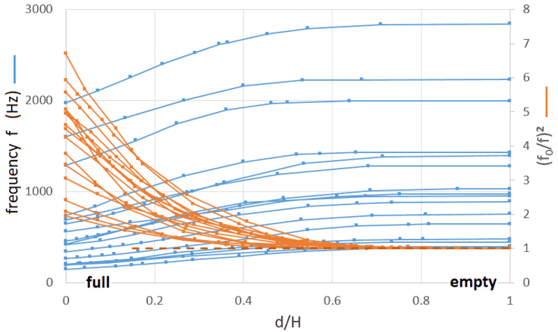

Sylvester McBean said:
Would the amount of water in the drum and the frequency/pitch of the sound be expected to have a linear relationship?
For vessels that do not have an upper lid, like wine glasses, the diagram of the frequency as a function of the height of the water is shown below. The fuller the glass, the lower the tone. The curved lines are approximately linear at both ends. The tangent line from the left intercepts the asymptote from the right at approximately d/H = 1/4. A.P. French (In vino veritas) derived a formula.
Blue lines: frequency of wine glasses as a function of the distance between the water level and the rim of the glass. H is height of the glass. Orange lines: same data, but (f0/f)2 on the vertical axis. f0 is the frequency of the empty glass.

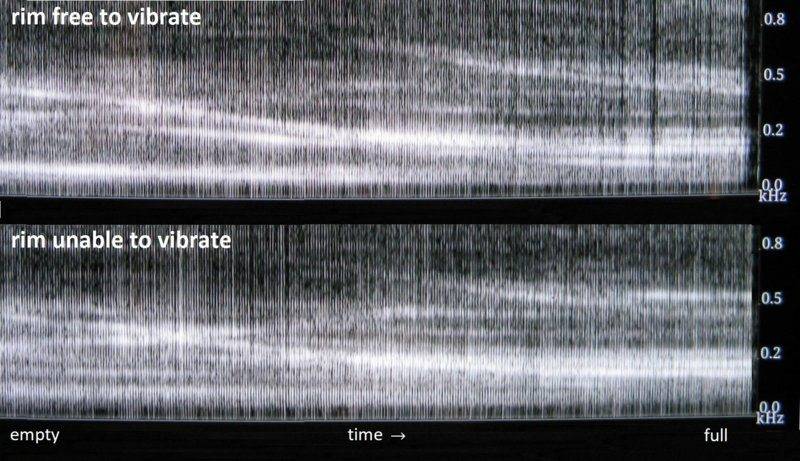

The OP asked if you bang on the side of a drum, what is causing the sound to have a particular frequency/pitch, and he mentioned the vibration of the steel wall and the vibration of the air as two possible explanations. I chose the first option. One consideration for me is that a bang on the side of a drum sounds like vibrating steel, not like resonating air. Another reason is that the OP specified that he banged on the side, as if he had noticed that a bang on the top lid produced another sound. Another sound would mean the sound was produced by a vibration of the steel wall. That is similar to a steel paper bin here in my room: a bang on the bottom sounds different than a bang on the side.
Below the sound spectrum, obtained with a smartphone, of banging on the side of the bin, while filling the bin with water. The frequency of several components decreased while the water was rising, as is typical for a vibration of the steel wall. In the second recording, labeled "rim unable to vibrate", I put my hand and arm on the rim to prevent it from vibrating. That was my poor man's imitation of a top lid. Although the sound quality was different, and the intensity of the components was different, the frequency decrease of several components was present again.
As the OP has access to an oil drum, he might check if a bang on the top lid sounds different than a bang on the side, and he might examine if the pitch decreases when the water rises. The change of pitch is audible, recording a spectrum is not required.
