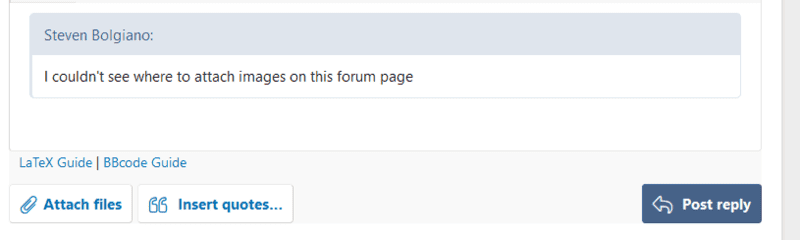

Steven Bolgiano said:
I couldn't see where to attach images on this forum page
Use the "Attach files" link in the lower left of your Edit window to attach PDF or JPEG files to posts...
