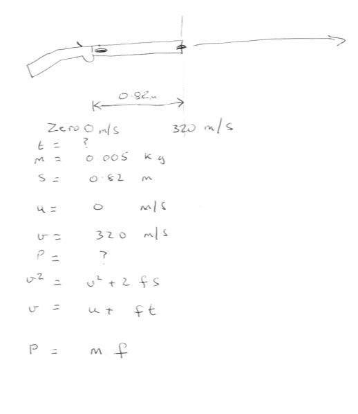

A good way to start is to draw a diagram.
Not a posh pretty one, just one to display the information given, such as the one at the top of my attachment.
Then write down all the knowns and the unknowns and a list of all the equations you know about this area of physics.
I have done this in the second part of the attachment.
Within the list of data (knowns and unknowns) you should find the unknown you are seeking.
You should also find some other unknowns, that you do not want to know.
Comparing the data list with the equation list you can start to pick out which equations will help obtain your wanted unknown.
You will find some equations not helpful as they obtain the wrong unknowns. You may also find that sometimes you need to calculate and intermediate quantity to reach your wanted one.
In my attachment I have shown this situation. You do not really require to calculate time so should avoid equations involving time.
Finally if you cannot find enough equations or data look again at your sketch. You may have missed something eg in my attachment the fact (not explicitly stated in the problem) that the bullet starts from rest.
Hope this helps and enjoy your future studies.
