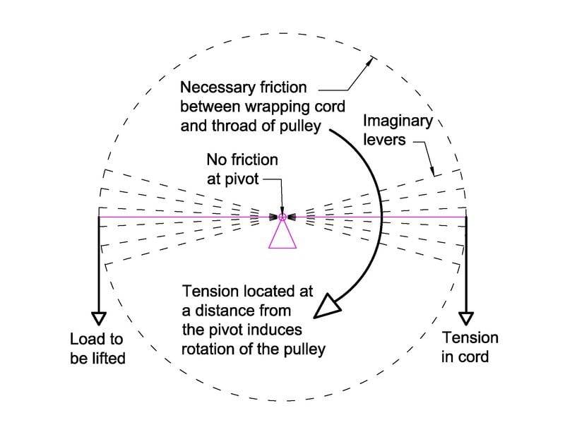

You’re right about that. But what really annoys me is the fact that I can’t find answers to the questions I ask. For example it was said that Tension is the only force acting on pulley and it exerts torque. I asked how can a force that pulls bodies exert torque on pulley? And there is no answer in textbook, I searched in another and couldn’t find it. And these things usually make me question whether something with my understanding is wrong. I am mostly self taught and have not been really good at physics when I studied it in primary school because I seemed disinterested due to having a really bad teacher and rarely ever studied it. So it’s been around few months since I tried truly studying for the first time and things don’t really go as smooth as I expected they will.

I'm not sure why you don't get this. The tension in the rope exerts a force on the rim of the pulley, which is free to rotate about its spindle. This is really the definition of torque -- A force applied perpendicularly to a lever multiplied by its distance from the lever's fulcrum (the length of the lever arm) is its torque. [wiki]
There are a few assumptions built in: the rope doesn't slip, no friction at the spindle, ...
The best way to bring this home is to do a bunch of problems that involve torque in the solution. Eventually you will see why it is a useful concept.
We are all here to help you understand, all you need to do is to keep asking questions until you deeply understand any subject.
A pulley is nothing more than many levers sharing a common pivot point.

I understood that tension appears in rope when it’s under some stress (some block pulls it for example) on one end and acts in a way to pull object (of course rope cannot push) - the rope exerts this force on objects attached to it. Now if I got it right, the entire system along with rope accelerates in one direction but there is static friction between pulley and the rope that tries to oppose the relative motion and acts on rope, but also the rope exerts tension on pulley in the opposite direction (which in this case is the direction the entire system is moving). This may be a little off-topic tho?
That static friction impedes any relative sliding of the rope over the pulley (it simplifies the problem as tangential velocities of rope and pulley are equal), but it does not consume any energy or interferes with the acceleration of the system.
High friction in the shaft or axle of the pulley would, reason for which is minimized or considered irrelevant.

Thanks for help!! I get it now!
