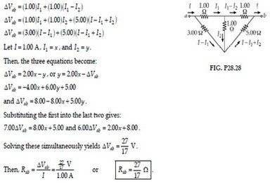

just a questiion aren't the 1-ohm resistance(upper left) and the 3-ohm resistance in series? . The definition for resitance in series is "Two or more elements are in series if they are cascaded or connected sequentially " ,aren't they sharing the same wire? so why aren't they in series?the wire I'm talking about doesn't separate in two branches too , I'm confused
look:View attachment 54025

Yes, they are in series. The 1Ω and 5Ω connected at "b" are also in series.
Hi tahnks for your reply well i don't think they are in series because in the solution they don't use the rules of resistances in seires or parallel to solve the problem .check it out
. but i need to know why . if someone knows please explain
Thanks for adjusting the problem statement :smile:. When you apply a voltage across a and b or a current through a and b, then there is a branch at a and at b, so they are not in series.
actually the original figure doesn't show that the branch at point "a" bifurcates. it only appears in the solution , but i guess i finally get it , i think it's because black dots (nodes) mean that there is always a bifurcation . now everything makes sense , thanks !
I read your original post literally. In my mind, a dot is a dot. To be more clear, show the attached voltage/current source. Then the branches will stand out. Glad you are clear!

haha there is no a voltage source in this problem, the problem just say that we have to prove that equivalent resistance between "a" and "b" is 27/17 ohm.That's it. :smile:
Well something was applied to inject a current, I, into a and outfrom b. Again, resulting in branches, therefore no series resistance.
If you consider what is meant by "equivalent resistance", then it is implied that you are finding what resistor could be placed between a & b and provide the same resistance to current flow as the given set of resistors. In other words, it's implied that there is a potential difference applied across a & b and an equivalent resistor would allow the same current to flow as given set of resistors.
This set of resistors cannot be analyzed on the basis of series/parallel analysis, unless you first do Y-Delta transformation.
The other common way to solve this is with Kirchhoff's circuit laws .
