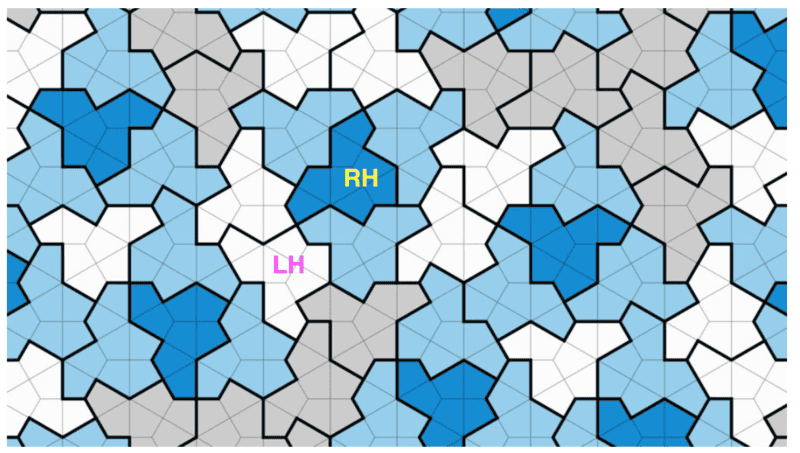

Is the "hat" shape really a single shape?
Recently there's been a lot of publicity about the discovery of a single shape that tiles the plane in a non-repeating manner. These are similar to Penrose tilings, but just use a single shape, while the Penrose tilings used two shapes. However, as I've played with these, I've realized that some of the "hats" are mirror images of others. So is it really fair to consider it a single shape? See the attached illustration showing that some shapes are right-handed(RH) and some are left-handed(LH). Is there a true single shape (without mirror imaging) that can do this? I'd appreciate comments.

That's a good question.
Look up what kinds of transformations are allowed in tesselation. In particular, is flipping (rotation about a line) a permitted form of transformation? A quick Google search yields some ideas but not a definitive source as yet.
I don't think "fairness" comes into it: what we have here is a single size of a single shape and its reflection which is clearly distinct from two distinct shapes without reflective symmetry such as the Penrose tiles (or multiple sizes of the same shape such as the Pinwheel tiles based on a concept by that other great modern polymath John Conway).
The authors of the original paper address this in a follow-up paper https://arxiv.org/abs/2305.17743. The best resource to explore this is probably the website created by one of the authors Craig Caplan at https://cs.uwaterloo.ca/~csk/hat/.
Permitted by whom? There are no Transformation Police!
There are. Penrose tiling and other forms of aperiodic tiling do have their own rules.
(At the risk of letting the cat out of the bag) one of them is that flipping is a valid transformation. A flipped tile is the same tile, just as much as a translated or rotated tile is the same tile.

DaveC426913 said:
So the question to the OP is: what group of tilings does the hat solution fall into (what does it solve? what are the constraints on the problem?), and does that type of tiling include flipping?
1) The tile covers the plane when flipping is allowed.
2) Iff the tile does not belong to an existing group,
Then a new group of 1 has been created.
QED :biggrin:

phyzguy said:
The article below says that the "specters" from the arXiv paper you linked in post #3, DO tile the plane aperiodically without reflections.
Yes, by my reading the claims about the Spectres do seem to be at odds with Bhattacharya's and Tao's proofs; however I am way out of my comfort zone here and cannot comment further.
In the summary of the paper you linked to it says:
"We prove that any finite set F⊂Z^2 that tiles Z^2 by translations also admits a periodic tiling."
It only mentions translation, not rotation, so this may be the key difference. Both the hat tile and the spectre tile must be rotated to tile the plane. Without that distinction, the proof would also make aperiodic tilings with multiple protiles (such as Penrose's) impossible.
