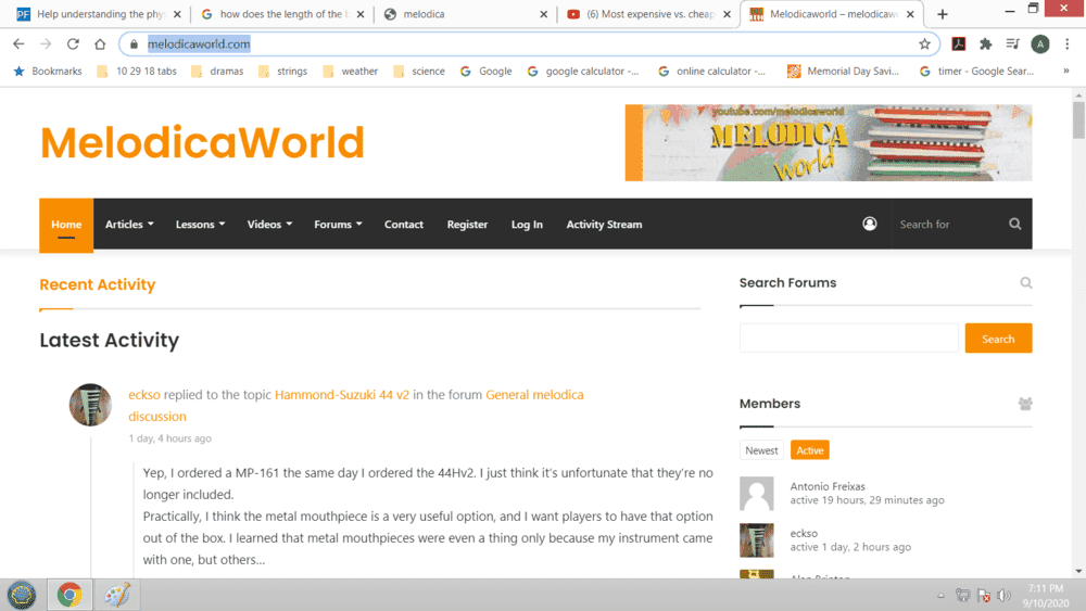

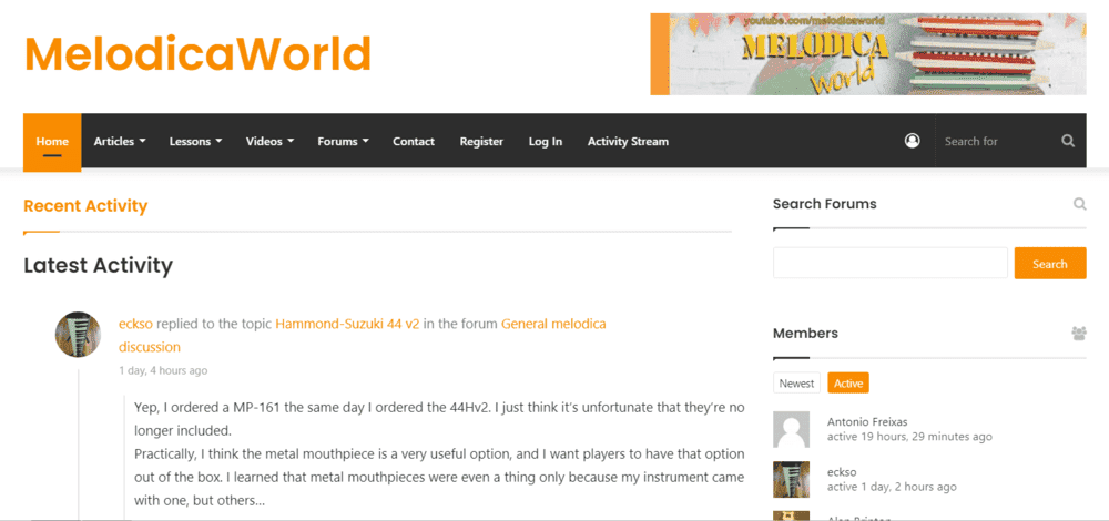

This guy sounds like an expert,
Experts and melodica forums here,
https://melodicaworld.com/

Actually, I am a member of Melodica World and familiar with a number of the members, including several who build melodicas. There are also some members who work for melodica manufacturers, but might be unwilling to share proprietary info.
