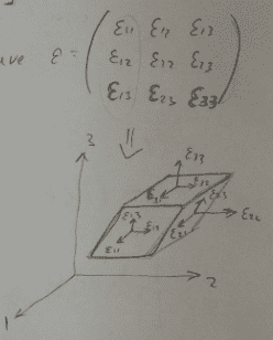

I see it like this:
1) Group the strain tensor elements in each direction:
ST1=(s11+s21+s31)*e1 ; ST2=(s22+s12+s32)*e2 ; ST3=(s33+s13+s23)*e3
then the "s " stands for epsilon (strain) and the numbers are the strain element of the tensor.
e1,2,3 are unit vectors in S1,2,3 directions respectively.
2) Now, simply project the ST1,2,3 on the unit vector in the phi-psi direction, the h of 9.31. That way you get the magnitude of the strain in the phi-psi direction, which is what we want and what should be 9.30 according to the book. (of course s21=s12, s13=s31 & s23=s32)
