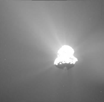

I cam across this picture from the Rosetta mission the other day. You'll notice the sun is illuminating the right hand side of the comet. Additional the tail is coming off the right hand side. This goes against what I've been taught about comets in that the solar wind pushes the tail the opposite direction from the sun. So what's going on here?
My personal thought: The FOV is small enough that we don't see the larger tail getting pushed away. Just some local effects from the sunlight. Does that seem reasonable?
Astronomy news on Phys.org
Read the description below the picture. It says that heat from the Sun causes the comet's nucleus to expel gas and dust, which is what we see in the picture. You may well be right about the field of view, and also perhaps the larger tail is too dark to see in the comet's shadow, especially next to the bright cloud and comet.
that doesn't answer the question ... we all know that that is what happens
I agree with the OP ... it seems incorrect and I am not sure why
Dave
I think that's just material expelled from the sunny side where the surface gets heated. Only subsequently the dispersed material floating around the nucleus gets blown away by solar wind to form the tail (which is a huge, diffuse structure only visible from afar).
It would be odd if it had these jets erupting preferentially on the dark, colder side.

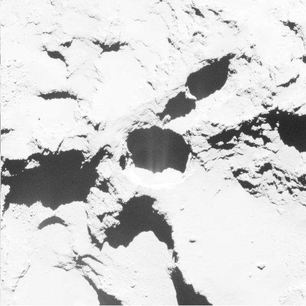

Oddly enough, a dark side jet was captured in the act of erupting the other day.
http://blogs.esa.int/rosetta/2015/04/20/osiris-catches-activity-in-the-act/
The scene at 07:15 CET on 12 March. Credits: ESA/Rosetta/MPS for OSIRIS Team MPS/UPD/LAM/IAA/SSO/INTA/UPM/DASP/IDA

That's to be expected - the comet is rotating, and the incoming heat gets conducted throughout its bulk. But the energy input comes from the illuminated side only, so the temperature will always be the greatest there (disregarding variations due to reflectivity, material composition, etc) and most of the jets should come off that side.
