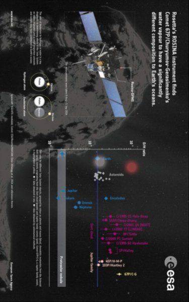

There is an ESA article about DH ratios
I annotated the figure to include the moon and Mars
Resolution isn't quite enough to actually make out any numbers. Could you give us a transcription, please?
Fantastic! Thank you very much.
sure
the visuals seem to show a very general, universal ubiquitous trend...
every "solid" body in the solar system is H depleted / D enriched
it's only a matter of degree, from Earth to the moon to Mars to asteroids and comets
conversely non solid gaseous bodies all seem to possesses solar or near solar ratios
looks to me like there is some process which affects all solid bodies, depleting H and or adding D, to which the sun and Jupiter are immune
U & N may have absorbed so many comets so as to increase their DH ratios in the cometary direction
that gets me thinking...
if U&N look like Jupiters and Saturns that grabbed terratons of comets
during the LHB ~4Gya
then UN grabbed comets that were already enriched in D relatively early in the life history of the solar system...
so what if comets' high D abundances are primordial ? What if D condenses into solid ices more readily than H? All the first icy snow flakes and hail stones in the solar system formed preferentially from DHO >> H2 O ??
if Earth water is more like ( less unlike) solar values...
whereas Mars is more like comets...
then maybe Earth somehow retained more H or water from the solar nebula...
whereas Mars only has secondary, cometary water ( from impacts after the huge polar impact that cratered half of the planet, say) ??
