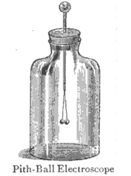

Possibly you are so extremely young that you don't remember that in the 19th century a pith ball was classified as a bad conductor, instead of as an insulator. The pith ball electroscope, the predecessor of the gold lead electroscope, consisted of two pith balls, connected by a conductive cotton thread, securely inclosed inside a well-dried glass jar or bottle, to prevent the discharge of the electricity from the balls into the surrounding air.(link) Had silk been used instead of cotton to connect the balls, they would not have received the necessary charge.
Engraved illustration of a pith-ball electroscope: two small pith balls hang on threads from a metal rod with a ball top, enclosed in a glass jar with a stopper. Caption reads Pith-Ball Electroscope.

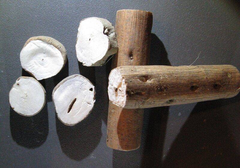

I bought some uncoated plain pith; interesting to see what it is made from. Again, if you touch a charged electroscope with a pith stick or a pith disc between your fingers, it discharges through the pith and your body. Plain pith is not a good insulator.
Photo of several pieces of plain pith on a dark surface: four white circular discs cut from the stem, and two brown cylindrical pith sticks, one lying across the other.
