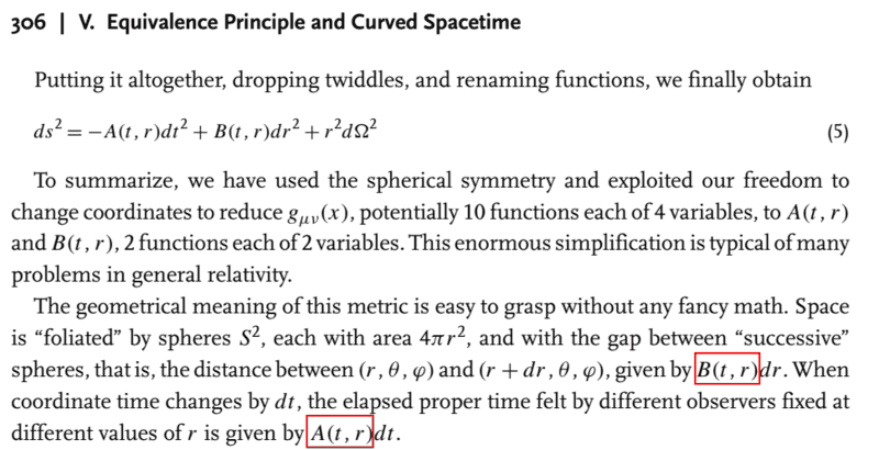

Thanks. Since we are on this book, I have another question: on page 306, lines 9 and 11 from the top, should B(t,r) and A(t,r) have square roots on them?
I believe so, yes. :smile:
