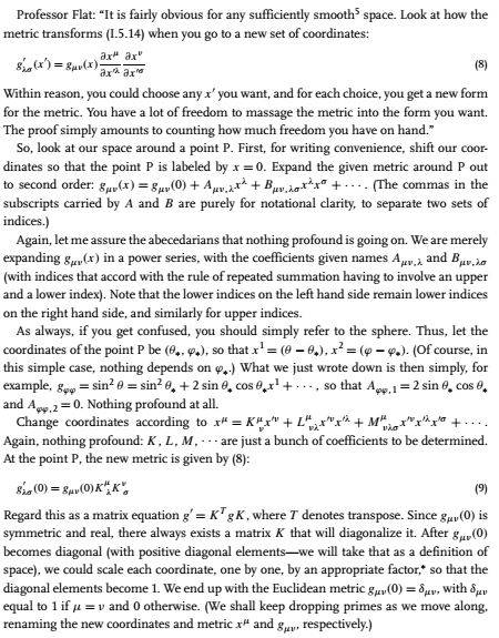

Zee writes (page 89):
To make sure that you follow this discussion, I suggest you try this fun exercise. Suppose
you were given a space described by the metricds [itex]ds^2=dr^2+r^2d\theta^2.[/itex] This is of course a plane as flat as Kansas, but suppose you didn’t know that. Calculate the curvature by first transforming polar coordinates into locally flat coordinates at the point [itex](r,θ)=(r_∗,0)[/itex] by going through all the steps here. Then extract the combination of the [itex]B_{\mu\nu,\lambda\sigma}[/itex]s giving the intrinsic curvature. By the end of this straightforward exercise, you will probably agree that there ought to be a better way to get at the curvature.
before that, he wrote,
So, look at our space around a point P. First, for writing convenience, shift our coordinates so that the point P is labeled by [itex]x=0[/itex]. Expand the given metric around P out
to second order: [itex]g_{\mu\nu}(x)=g_{\mu\nu}(0)+A_{\mu\nu,\lambda}x^{\lambda}+B_{\mu\nu, \lambda \sigma} x^{\lambda}x^{\sigma}+...[/itex]
(The commas in the subscripts carried by [itex]A[/itex] and [itex]B[/itex] are purely for notational clarity, to separate two sets of indices.)
Trying to solve the problem. I expanded in a series metrics as mentioned [itex]g_{\theta\theta}(r) = r^2_*+2r_*(r-r_*)+2(r-r_*)^2[/itex]
I see that [itex]B_{\mu\nu, \lambda \sigma}=B_{\theta\theta,r r}=B_{22,11}=1[/itex].
How can I get intrinsic curvature?

Zee apparently tells you how he wants you to do this. Your quote from the book says,
Calculate the curvature by first transforming polar coordinates into locally flat coordinates at the point (r,θ)=(r∗,0) by going through all the steps here.

I think you must go on to the next page. Normally the curvature would depend on both the A's and B's. Since the expression you gave involves B's only, Zee must expect you to transform the coordinates further to eliminate the A's.
Well, put the problem in another way. Let us forget for a while about Zee. How to find locally-flat coordinates (x,y) on the sphere at a north pole, say? What it means to find? It is clear that they are Cartesian, so I need to find transition formulas.
From what you've said, I still don't know just what Zee is planning to do. What he's calling "locally flat coordinates" are more usually called quasi-Cartesian coordinates or normal coordinates at a given point P. To find them, one can
a) Choose a set of orthonormal vectors Xi at P.
b) Solve the geodesic equations to construct a set of geodesics starting at P with initial tangent Xi.
c) Use these geodesics as a set of coordinate axes in the neighborhood of P, defining the normal coordinates as distance measured along each axis.
Just a roundabout way of finding coordinates in which the Christoffel symbols vanish at P, which is what Zee's A coefficients are.
