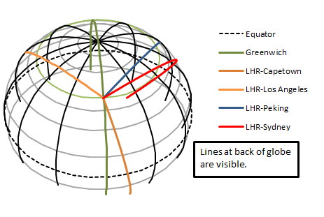

I have not yet tried to solve these equations, but I know that a geodesic on a sphere is a great circle so I can work out its equation and it can be written
\begin{align}
\theta=\lambda\ \ ,\ \ \phi=\tan^{-1}{\left(\frac{C}{A\cos{\lambda}+B\sin{\lambda}}\right)}&\phantom {10000}(8)\nonumber
\end{align}where ## A,B,C## are constants depending on the start and end points (in quite a complicated way.) It should be simple to check that (8) satisfies (6) and (7). Clearly ## \phi## depends only on ## \theta## and the start and end points, as one would expect. This leads to the original question.
I checked my equation (8) by using my wonderful 3-D plotter. The geodesics look perfect.
I also searched the internet for the equation and found one on Wolfram MathWorld (http://www.mathworld.wolfram.com/GreatCircle.html). It was slightly different from mine and cause me great pain. It is incorrect! Their colatitudes and latitudes are mixed up. I have told them, but there is no response. I also plotted their solution and it gave a rather long route to Peking. Whatever the case ## \phi## depends on ## \theta## and the start and end points.

It seems to me that ##\phi## and ##\theta## are independent, meaning that ##\phi## is not a function of ##\theta##. As you said, ##\phi## is the angle measured from the north pole (z-axis), and ##\theta## is the angle measured from what would be the x-axis in the x-y plane. The two coordinates are independent, so ##\partial \left(\frac{ \sin^2(\phi)}{\partial \theta}\right) = 0##.
Likes George Keeling
Thanks, but then there's my equation (8) which effectively says that$$
\phi=\tan^{-1}{\left(\frac{C}{A\cos{\theta}+B\sin{\theta}}\right)}
$$ so it might seem that ##\phi## does depend on ##\theta##. This is my quandary. :cry:
But this isn't consistent with your descriptions of what ##\phi## and ##\theta## represent. If they truly are spherical coordinates, they are unrelated to each other.
Equations ##(8)## look like a parameterization of a certain path, not a general dependence.
fresh_42 said:
Equations (8) look like a parameterization of a certain path, not a general dependence.
Indeed it is the equation of a curve, light dawns! 💡Thanks, I can get on.
