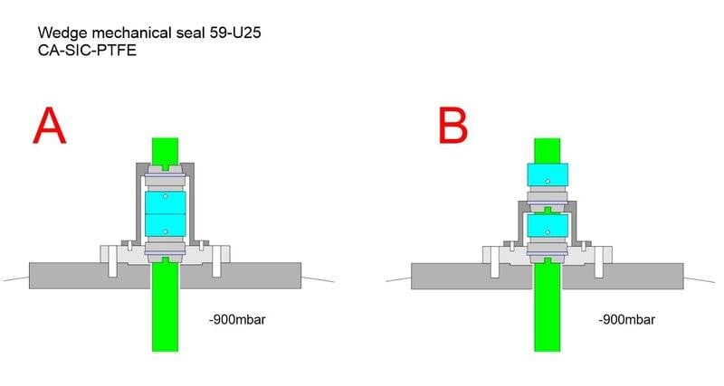

Hello all,
I will use two 59U-25 ca-sic-ptfe wedge mechanical seals, in a top mounted, low speed (14rpm) mixer. Solvent heated to 100 celsius, -900mbar vacuum applied. So, steam will be in contact with the seal. I was wondering, how is the right way to install these?
Back to back or tandem?
Thanks!
Two cross-section diagrams labelled A and B of a wedge mechanical seal 59-U25, CA-SIC-PTFE, with the pressure -900mbar marked under each; the seals differ in the arrangement of their cyan and green parts.
Lnewqban said:
Welcome, @heiken01 !
What the manufacturer of the seals recommend?
Hi! Purchased on Alibaba. They dont know either
I believe Alibaba is just a reseller, like Amazon or eBay. What is the brand of the seals? Who is the manufacturer? That is who you need to ask.
