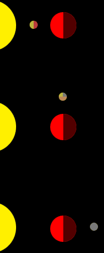

Now, for some questions about illuminations. Here's a picture of what I think will happen in this highly simplistic arrangement:
So, if the moon is between the sun and the planet, then it's pretty obvious. The sun side is bright, the planet side is darker.
Now, if the moon is off to the side (I'm sure there's a word for this), then am I right that, roughly, one quadrant is in darkness, one quadrant has only sunlight, and the other half are illuminated by the sun and the planet? Would that be noticeably brighter than just having sunlight?
Finally, when the planet eclipses the sun, are all parts of the moon going to be equally dark, or will planet/space side be more illuminated? Would the answer change if the planet were a gas giant?
Quadrature.
You are forgetting the fourth quarter, both in text and on your picture.
At most, it is a few % of sunlight. It does not create a very strong and clear difference at the edge where sun is high. And there will not be sharp shadows because the planet is big. If you look at the shadow of a sharp edged obstacle, it will have only a slight contrast between sunlit shadow and fully lit part, and the edge broadens and smears out very rapidly.
But the matter is very different near terminator. The illumination on horizontal surfaces by Sun on horizon, plus twilit sky, is estimated as 0,6% of full sunlight - twilit sky alone, with Sun under horizon, is 0,3 %. So there the half phase planet high in the sky does outshine the sunlit twilit sky.
It depends, basically, on twilight into umbra. Which is very hard for me to derive from first principles.
