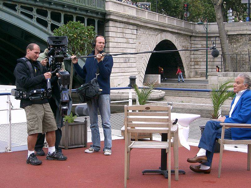

But if you want good sound quality, one of the things you'll want to invest in is an off-camera microphone and boom.
The camera's microphone shouldn't be used for good sound quality, or if it is used, should only be used as a last resort. The on-camera microphone's main source of sound might be coming from the camera itself. But by plugging in an off-camera microphone into the camera's microphone input jack, you can move the microphone closer to the subject, where it should be.
It doesn't have to be as fancy as the one pictured above. You might want to google "microphone boom" to build your own. Microphones themselves vary in price quite a lot. But even a cheapy one, off-camera, should still be an improvement to the on-camera mic.

That's a good idea about the boom, that is a way to make it sound more professional, instead of the voice of someone across the room sounding like they're far away. I wanted to try my first film by myself. Is it possible to do the boom thing without someone holding it?
