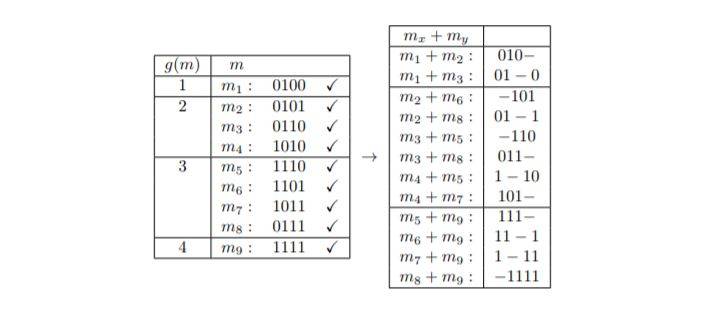

We calculate the weight of each term:
\begin{align*}&g(x_1^0x_2^1x_3^0x_4^1)=2 \\ &g( x_1^0x_2^1x_3^0x_4^0)=1 \\ & g( x_1^0x_2^1x_3^1x_4^0)=2 \\ & g( x_1^1x_2^1x_3^1x_4^0)=3 \\ & g( x_1^1x_2^0x_3^1x_4^0)=2 \\ & g( x_1^1x_2^1x_3^1x_4^1)=4 \\ & g( x_1^1x_2^1x_3^0x_4^1)=3 \\ & g( x_1^1x_2^0x_3^1x_4^1)=3 \\ & g( x_1^0x_2^1x_3^1x_4^1)=3\end{align*}

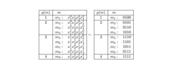

We create the following table:
Two terms $m$ and $m'$ can be combined when $|g(m)-g(m')| = 1$. That means that we have to compare all terms of two neighboring classes if they differ by one negation.
We get the following:

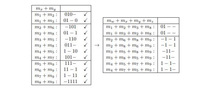

We can combine two rows if they have "-" on the same position.
No more combinations can be done.
So we have the four prime terms:
\begin{align*}p_1=m_1+m_2+m_3+m_8=x_1^0x_2^1=\bar{x}_1x_2 \\ p_2=m_2+m_6+m_8+m_9=x_2^1x_4^1=x_2x_4 \\ p_3=m_3+m_5+m_8+m_9=x_2^1x_3^1=x_2x_3 \\ p_4=m_4+m_5+m_7+m_9=x_1^1x_3^1=x_1x_3\end{align*}

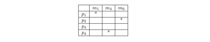

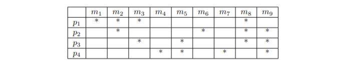

The table of prime terms is:
The columns are pairwise compared to whether there is not a column in which the marked primer terms are a subset of the marked primer terms of the other column. If this is the case, then the superset column can be deleted because all conjunctions must be detected, and therefore the conjunction with the superset is also included by selecting the conjunction with the subset.
We can delete the columns $m_2, m_3, m_8$ due to the column $m_1$. We can delete also the columns $m_5, m_7, m_9$ due to the column $m_4$.
Then the table looks as follows:

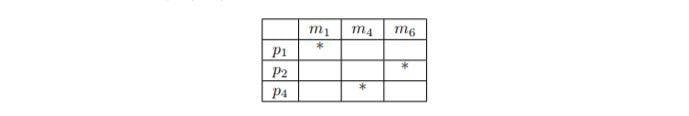

Now we compare the rows (prime terms) of the table in pairs, if there is not one row in which the marked minterms are a subset of the marked minterms of the other row. If this is the case, then the primerm with the subset can be deleted, because one can take the other primerm as a substitute for each marking of the primed primer. The relation is exactly the opposite here as with the columns.
We delete the (empty) row $p_3$ and so we get
View attachment 8993 Therefore we have the prime terms $p_1, p_2, p_4$.
Now the selected prime terms have to be linked to the solution equation by disjunction:
\begin{equation*}p_1\lor p_2\lor p_4=\bar{x}_1x_2\lor x_2x_4\lor x_1x_3\end{equation*}
Is everything correct? (Wondering)
