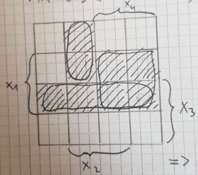

I am looking the following:
Determine a disjunctive normal form for the expression $$x_1\left (\left (x_2x_3\lor \bar{x}_2x_4\right )\lor x_2\lor x_3x_4\right )\lor x_2\bar{x}_4\bar{\left (\bar{x}_1x_3\right )}\lor x_1x_3\bar{x}_4$$ and minimize it using a Karnaugh Diagram.
The above expression is equivalent to $$ x_1x_2x_3\lor x_1\bar{x}_2x_4\lor x_1x_2\bar{x}_3x_4\lor x_2\bar{x}_4x_1\lor x_2\bar{x}_4\bar{x}_3\lor x_1x_3\bar{x}_4$$
Does each term has t contain all the variables? If yes, then if one variable is missing then we replace that by $x_i\lor \bar{x}_i$.
If we have to do that in that way and we simplify the expression and so we get: $$x_1x_2x_3x_4\lor x_1x_2x_3\bar{x}_4\lor x_1\bar{x}_2x_3x_4\lor x_1\bar{x}_2\bar{x}_3x_4\lor x_1x_1\bar{x}_3x_4\lor x_1x_2\bar{x}_3\bar{x}_4\lor \bar{x}_1x_2\bar{x}_3\bar{x}_4\lor x_1\bar{x}_2x_3\bar{x}_4$$
Is this a disjunctive normal form that we arelooking for? (Wondering)
To create the Karnaugh Diagram, is the form of that diagram always the same? I mean how we name the edges $x_1, x_2, x_3, x_4$, as for example:
To fill that diagramm do we need the expression to contain all the variables? I mean could we do that if we have the above expression in the form $$ x_1x_2x_3\lor x_1\bar{x}_2x_4\lor x_1x_2\bar{x}_3x_4\lor x_2\bar{x}_4x_1\lor x_2\bar{x}_4\bar{x}_3\lor x_1x_3\bar{x}_4$$ ? (Wondering)
Could you explain to me that method? After filling that table how can we continue to determine the minimal expression? (Wondering)
  • Hand-drawn 4-variable Karnaugh map on grid paper with x1 labelling the rows, x2 the columns below, x3 and x4 on the right and top; several hatched regions mark groups of cells.

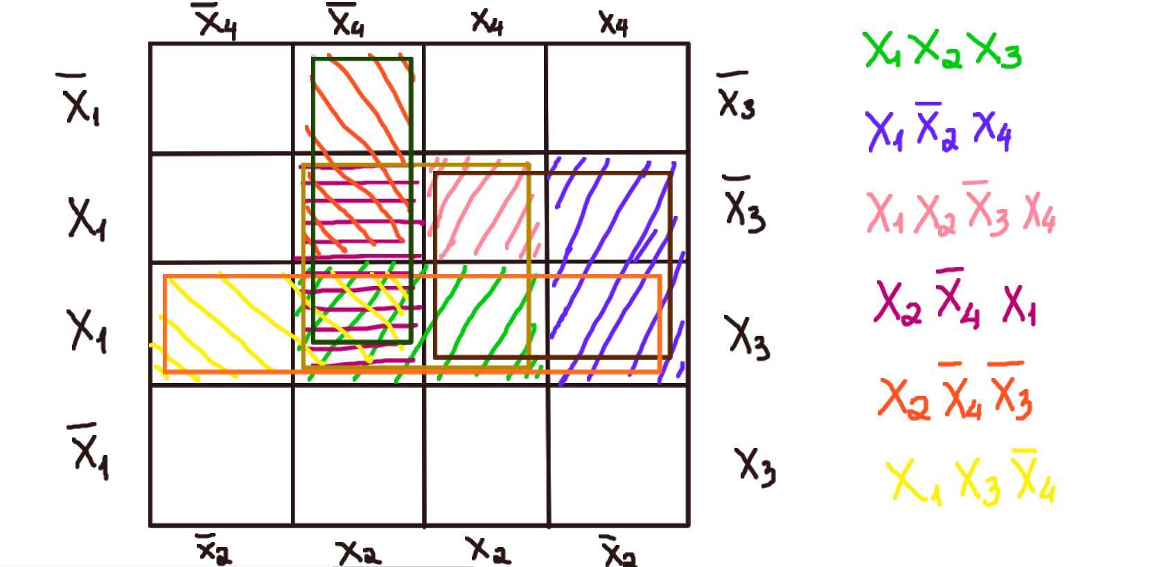

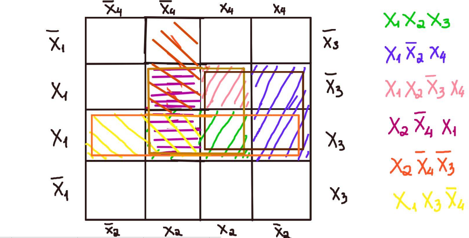

So, do we get the following?
Klaas van Aarsen said:
A gray code sequence is for instance 000, 001, 011, 010, 110, 111, 101, 100.
Note that every step there is exactly one digit that switches from 0 to 1 or vice versa.
In the Karnaugh diagram we use the sequence 00, 01, 11, 10 on each side.
It encodes where each of the variables is 0 respectively 1.
Graphically each of the variables corresponds to a rectangle of 8 cells.
The gray code sequence means that none of those rectangles share a boundary.
When we move from one cell to then next, we always cross exactly one of those rectangle boundaries.
It makes it easier to spot simplified coverings with rectangles that are as big as possible.
When we find the biggest rectangles that cover all ones, we have found a prime implicant. (Thinking)
How exactly can we find the prime implicant from the above diagram? I haven't really understood that. (Wondering)
  • Hand-drawn 4-variable Karnaugh map with 4x4 cells, column headers x4-bar, x4, x4, x4-bar (top) and x2-bar, x2, x2, x2-bar (bottom), rows labelled x1-bar, x1, x1, x1-bar (left) and x3-bar, x3-bar, x3, x3 (right), with six colour-coded groupings and their terms listed alongside.
Looks good to me. (Nod)

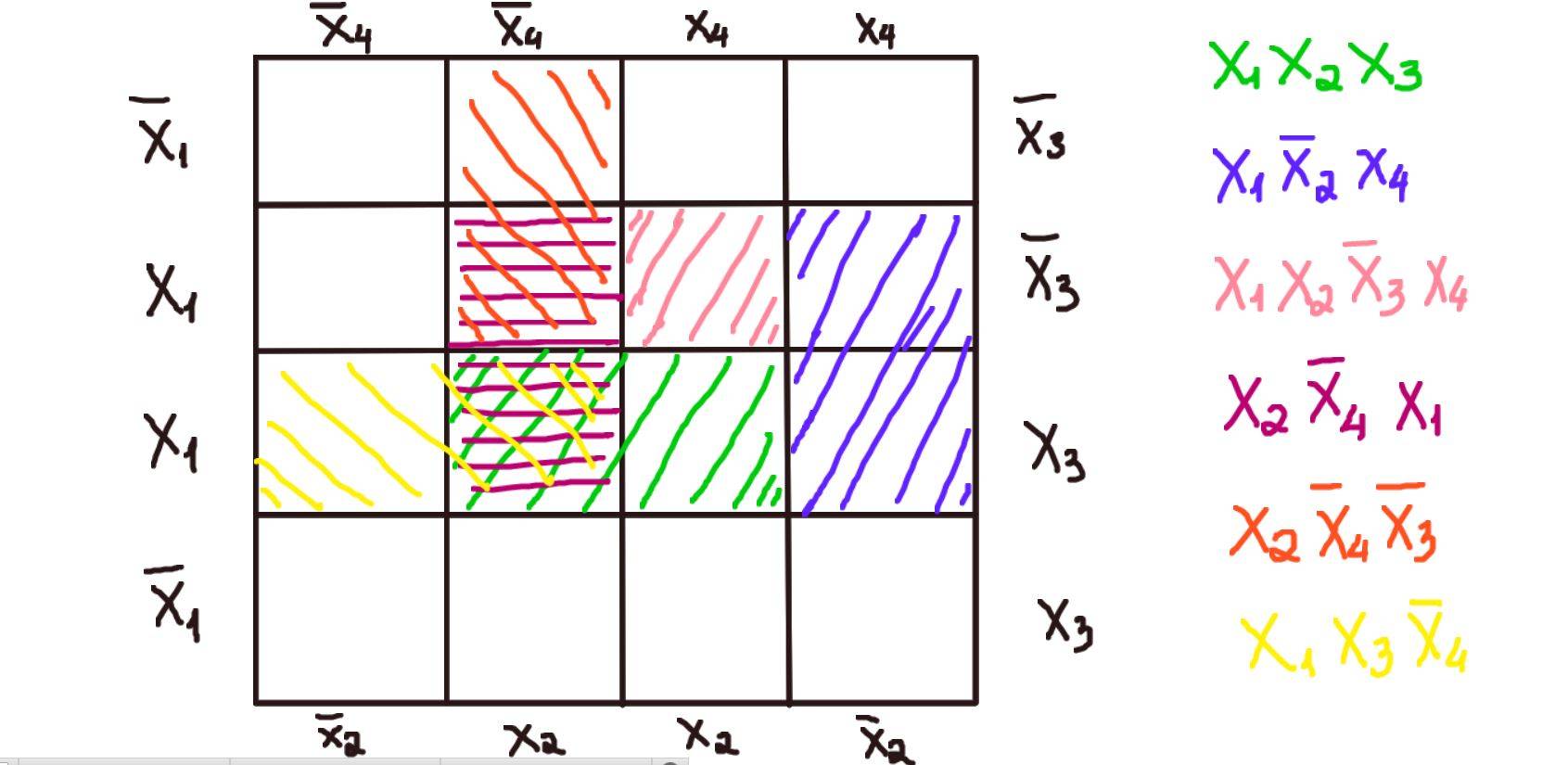

What is the largest rectangle that fits into the marked cells? One that corresponds to a conjunction of 1 or 2 variables? (Wondering)
Do we get these two rectangles? (Wondering)
  • Four-variable Karnaugh map on a 4x4 grid with hand-drawn coloured loops in green, yellow, orange, purple, pink, blue and brown, with row labels X1 bar, X1, X1 and X1 bar, and column labels X4 bar, X4, X2 bar and X2; a colour key lists the product terms.
Yep. (Nod)
Can we find another one with 2 variables? (Wondering)

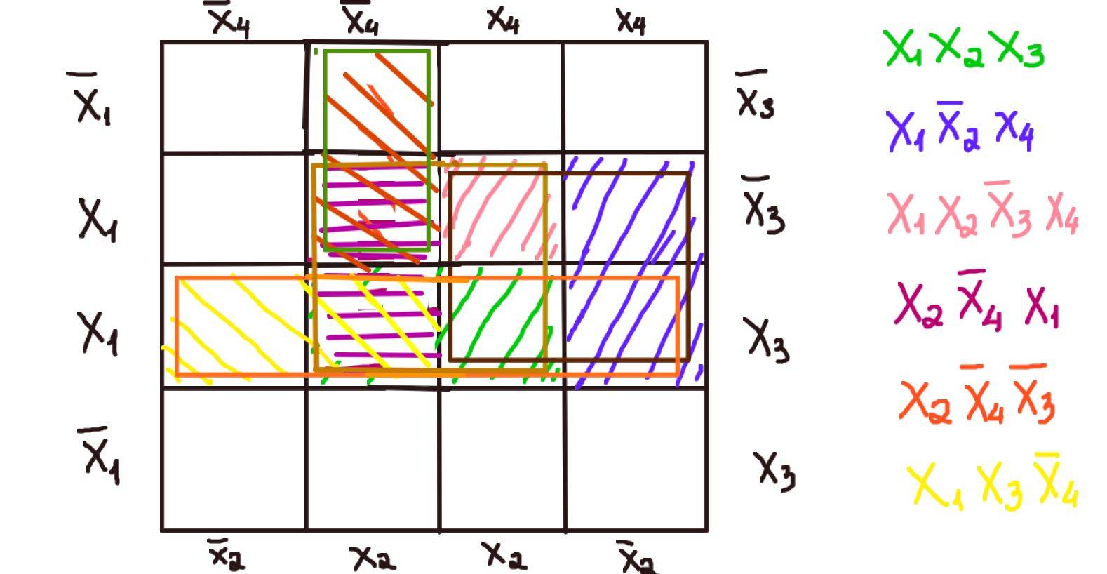

Which one do you mean? I got stuck right now. (Wondering)
Isn't there a 1x4 rectangle? (Wondering)
So, do we have the following $4$ rectangles? (Wondering)
  • Hand-drawn 4-variable Karnaugh map, 4x4 grid with X1, X2, X3, X4 labels on the edges, six coloured rectangular groupings drawn over the cells, and a colour key listing each group's product term.
You found the 1x4 rectangle!
But... can we write that 3x1 rectangle as a conjunction of 3 variables? (Worried)

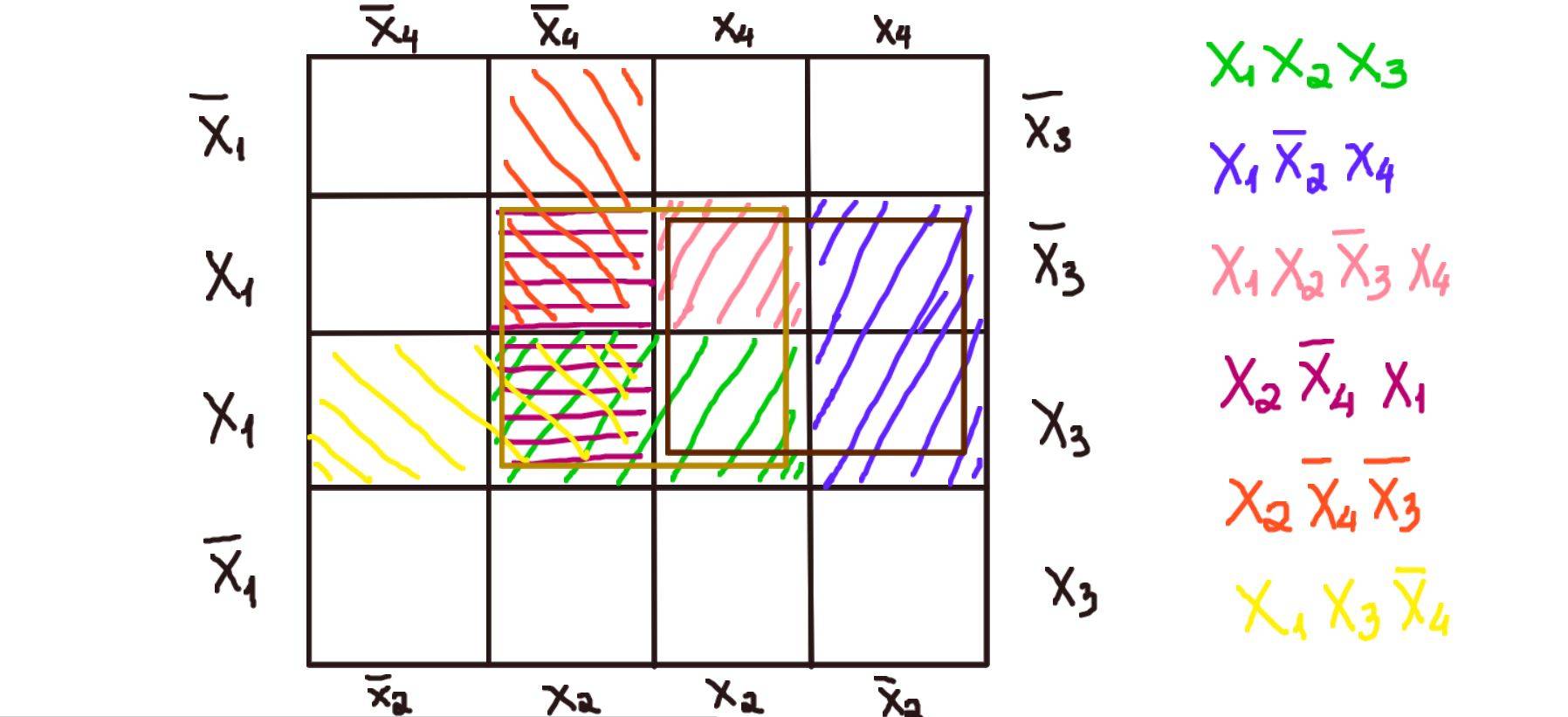

Is this 3x1 rectangle a conjuction of just 2 variables? (Wondering)
mathmari said:
Is this 3x1 rectangle a conjunction of just 2 variables?
I don't think so. (Shake)
One variable gives us a rectangle of 8 cells. Either 2x4 or 4x2.
Although it may 'go over the border and around to the other side'. That is, it can also be for instance two rectangles of each 1x4.
Two variables gives us a rectangle of 4 cells: 2x2 or 4x1 or 1x4.
Three variables gives us a rectangle of 2 cells: 1x2 or 2x1.
Four variables gives us a rectangle of 1 cell.
Don't they? (Wondering)
So, if the given expression contains 4 variables, as in this case, are we looking for 2x2 or 4x1, 1x4, 1x2 or 2x1 and 1x1 rectangles in the diagram? (Wondering)
Yes.
Or 4x2 / 2x4. Those do not fit in this case though. (Thinking)
Yes.
Therefore, in a general case we are looking for 2x2, 2x4, 4x2, 4x1, 1x4, 1x2, 2x1 and 1x1 rectangles, aren't we?
So, in this case we are considering the following rectangles, right? (Wondering)
How do we continue now? Do these 3 rectangles represent 3 prime implicants? (Wondering)
Yes.
We need a 4th rectangle to cover the 2nd cell don't we?
Perhaps we can use $x_2\bar x_3\bar x_4$ ? (Wondering)
Together those 4 rectangles form a prime implicant yes.
If we leave out any of the rectangles or if we enlarge one of them, then they do not form an exact cover any more do they? (Thinking)
EDIT: Oh wait, we can leave out one of the rectangles, can't we? And still have an exact cover? (Thinking)

So, we have to find rectangles so that all cells are covered, right?
Do we get then the following?
View attachment 9017 Could you explain to me further what you mean at the Edit? (Wondering)
  • Four-variable Karnaugh map in a 4x4 grid with hand-drawn coloured rectangles grouping cells, plus a legend listing product terms such as x4 x2 x3, x1 x̄2 x4, x2 x̄4 x1 and x1 x3 x̄4.
Yes. Can we identify the expressions that correspond to them? (Thinking)
Suppose we leave out the rectangle in the center. The one that is identified by $x_1x_2$. Do we still cover all the required cells then? (Wondering)
We get the terms $x_2\bar{x}_3\bar{x}_4, \ \ x_1x_3, \ \ x_1x_4$ and so the expression $x_2\bar{x}_3\bar{x}_4\lor x_1x_3 \lor x_1x_4$.
Is that correct? (Wondering)
Yes. So, can we ignore that rectangle and we get still all the prime implicants? (Wondering)
Is that correct?
Yep. All correct. (Happy)
