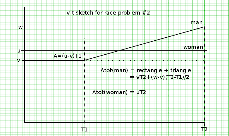

2. A women is 0.056 km ahead of a man in a race. The women is jogging at a constant rate of 3 m/s while the man is jogging 2.3 m/s until he decides to catch up to the women and accelerates at 1.2 m/s.
A) How far does the man have to travel to catch up to the women?
Please help. I don't understand these at all.

This time your graph is much the same except it is the woman who is constant and the man who changes ... and his line does not start from v=0.
the man and the woman travel at constant speed until the woman is ahead of the man by a given amount. So draw that in. You know the two speeds, but you don't know the time so put a T1 in on the time axis (because there are two parts to the motion).
The the man accelerates until time T2, when he's caught up again.
We want the distance traveled by the man between T1 and T2.
As before, the total distance traveled (from 0 to T2) by both of them is equal.
You just have a more complicated area - that's all.
You deal with complex areas by dividing them into simple areas.
The man's graph is a rectangle and a trapezium.
That's what I said :)
There's a shortcut with the graph too but you are having a hard enough time understanding what is going on without me showing off my math-foo. I'll stick to the standard method:
Here's a more general form of the diagram...
u is the speed of the woman jogging. the man starts out at v until he decides to put a spurt on at t=T1. Can you see that the lead the woman has by T1 is the area between u and v in this region? (distance is area remember?)
Since you know u and v you can get T1. That leaves T2 and w you don't know.
Since this is homework, there is a limit to how much I can tell you.
Go through the geometry and leave the variable every time you don't know something.
Use algebra to find the missing values.
