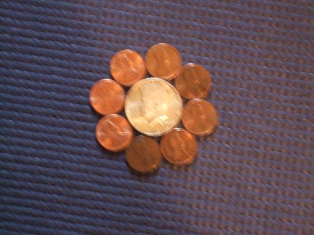

A simple trigonometry problem: Put eight coins around a central coin. Compute the required ratio of the radii of the inner coin to the outer coin(s).
I have a simple trigonometry problem. I thought of making this as one of the math challenge problems, but it is almost too easy for that. ## \\ ## It is well known that 6 coins (circles) of equal size can be put around a center coin of the same radius, with the outer coins each touching two other outer coins plus the center coin. The problem is to compute with outer coin of radius "a" and inner coin of radius "b", what is the ratio of ## \frac{b}{a} ##, if there are 8 coins of radius ## a ## around the center coin of radius ## b ##? ## \\ ##
Once you have solved for the answer, you might find it of interest that 8 U.S. pennies fit almost (but not quite) perfectly around a JFK 50 cent piece. If you google the sizes, you will see why.
## \\ ## Just for the fun of it, I welcome any high school level students to post an answer. ## \\ ## My post here is of a different nature than what I normally post= I'm hoping the section I picked is suitable for this post= @fresh_42 Hopefully this one is ok.
Mathematics news on Phys.org
For coin sizes, see https://en.wikipedia.org/wiki/United_States_Mint_coin_sizes
## \\ ## And a hint to the above problem: It is a simple application of the law of cosines. ## \\ ## I will post the solution in a day or two if no one else posts it.## \\ ##
Edit: 30.6 mm/19.05 mm=1.606. As we see below, (post 3), the answer is 1.613 (approximately) so the JFK half dollar is just ever so slightly smaller than necessary to put the 8 pennies around it.
And here is the solution: Let ## a ## be the radius of the smaller outer coins, and ## b ## the radius of the coin in the center. By the law of cosines ## C^2=A^2+B^2-2AB \cos{\theta} ##.
Here ## \theta=45^{\circ} ## because the circle gets divided in eight parts.
## C=2a ## , and ## A=B=a+b ##.
That makes ## 4a^2=2(a+b)^2-2(a+b)^2 \frac{\sqrt{2}}{2} ##.
This gives ## \sqrt{\frac{4}{2-\sqrt{2}}}-1=\frac{b}{a} \approx 1.613 ##.
Here's the 8 pennies around the JFK half dollar. The last penny pushes the others out ever so slightly when it is put into place.

fresh_42 said:
The centers of all touching outer coins are at a distance ##R+r## from the center of the large coin per definition of touching. That draws my black circle. The question is whether two neighboring small coins need to touch at ##P## which I'm currently not sure about.
I think the centers of the eight outer coins form a regular octagon. The contact point between two coins must lie on the straight line joining their centers, which would place the contact point between two outer coins on the sides of the octagon. I think your point ##P## is on the octagon's circumcircle, so would lie slightly outside the contact point of the circles.
@fresh_42 If you make ## R ## very small, I think you will see how your diagram is misleading. In that case, the edges of the pie shape that make the angle ## \phi ## will certainly pass inside the circle of radius ## r ## to make contact at the point ## P ##.
The above observation leads directly to ##\sin(22.5°)=\frac{r}{R+r}##, which solves to the ~1.613 ratio in #3.
