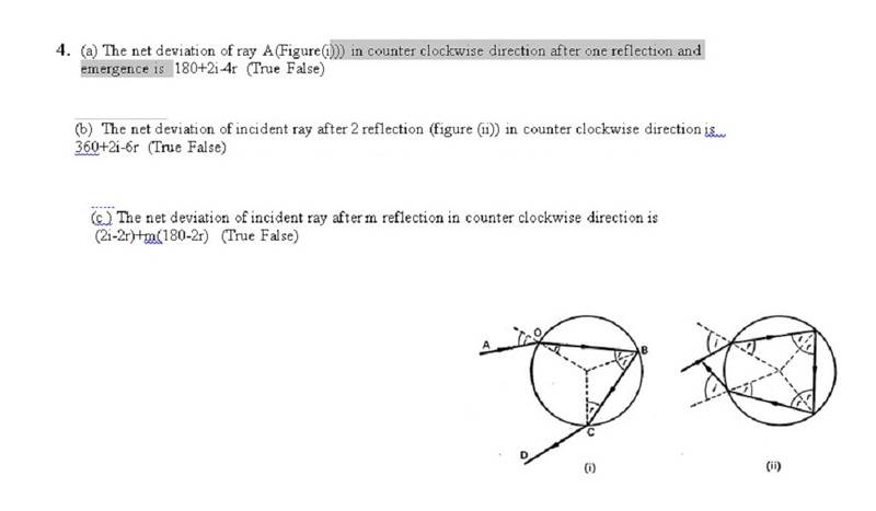

The net deviation of ray A(Figure(i))) in counter clockwise direction after one reflection and emergence is 180+2i-4r (True False)
I don't know how to begin to solve this problem, so there is no attempt at a solution.
The 'relevant equations' section is where you can post any standard equations from theory that you believe may be relevant. Equations only related to the specific question belong in the problem statement.
Even if you don't understand how to start on the problem, you surely have some thoughts about it that you can share. This helps us understand where/why you are stuck. E.g., do you understand what is meant by a net deviation?
:[/B]
Snell's Law isall i have for relevant equations.
n_1 sintheta = n_2 sin_theta

Ok, but that won't help here. It is purely a matter of geometry.
You didn't answer my question: do you understand what is meant by net deviation? Start with something simple - what is the deviation of the ray, in counterclockwise sense, at the internal reflection step?
Ohhh...I don't understand what is meant by net deviation. What exactly is it in relation to this problem?
If something changes the direction of a ray the ray is said to have been deviated. The extent of the deviation is the angle (measured anticlockwise) by which the direction has changed. So if a ray strikes a mirror along the normal it will be deviated 180 degrees. If it strikes it at 30 degrees to the normal it will be deviated by either 120 degrees or 240 degrees.
After a sequence of deviations, the net deviation is the overall change in direction.
So, can you figure out the deviation that results from the internal reflection in the diagram?
Alright, so this mean that the internal deviation is the path the ray originally took, and thus, it has deviated in the same direction, but counter clockwise.
So, then it can't be a 360 degree deviation, right?
Sorry, I'm still studying this topic.
Alright, so if a ray strikes at 30 degrees to the normal, how is it deviated 120 or 240 degrees?
Suppose the ray starts left to right at 30 degrees above the horizontal and strikes a vertical mirror. The reflection will go right to left, still at 30 degrees above horizontal. If you take the path of the ray as it is about hit the mirror and rotate it anticlockwise until it matches the path just after reflection from the mirror, what angle do you rotate the ray by?
