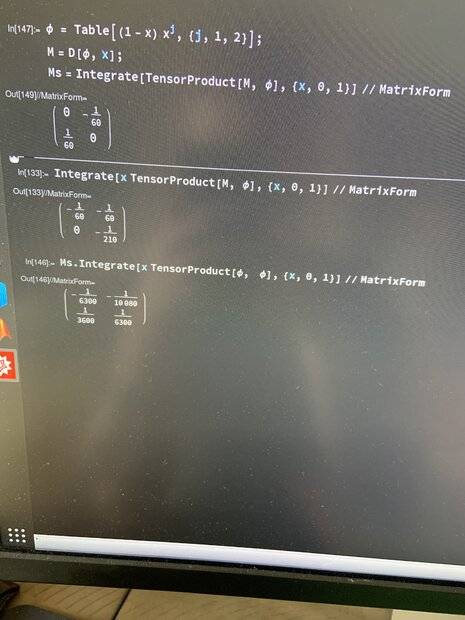

I'm trying to understand this, but I think I'm missing something. If We define ##M = d/dx## and let ##\phi_{1,2} = (1-x)x, (1-x)x^2## with [itex](\cdot,\cdot)_1 = \int_0^1 \cdot \cdot[/itex] then [itex]\tilde{M} = 0,-1/60; 1/60,0[/itex]. If we let [itex](\cdot,\cdot)_2 = \int_0^1 x \cdot \cdot[/itex] so that it's a different inner product then we get ##(M(\phi_i),\phi_j)_2 = -1/60,-1/60; 0, -1/210##. But ##(\phi_k,\phi_j)_2\tilde{M}_{ki} = -1/6300, -1/10080; 1/3600, 1/6300##. So it seems the two different inner products give different results and don't uphold the equality. Am I missing something?
Screenshot of a Mathematica notebook showing Table[(1 - x) x^j, {j, 1, 2}], M = D[phi, x], and Ms = Integrate[TensorProduct[M, phi], {x, 0, 1}] in MatrixForm, with 2x2 matrix outputs.
This might be easier to see

I of course meant that the values of [itex]\lambda[/itex] for which [itex]\det(\tilde{M} - \lambda \tilde{K}) = 0[/itex] are the same as those for which [itex]\det(P\tilde{M} - \lambda P\tilde{K})) = 0[/itex], since [itex]\det(P) \neq 0[/itex]. Naturally if [itex]P[/itex] is not the identity then [itex]P\tilde M \neq \tilde M[/itex].
Wow, I feel stupid. Like REALLY stupid. But seriously, thank you so much!
