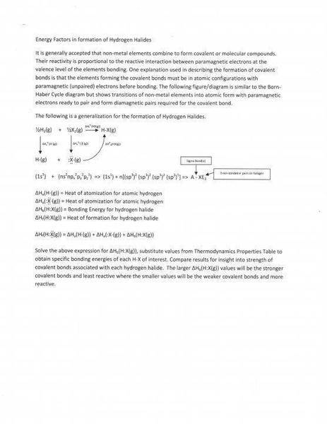

I couldn't structure the energy flow diagram directly, so I typed it out in word and posted in jpeg. Hope this helps.
ΔHaX(g) = Heat of atomization for halogen, not hydrogen. My mistake.

Not exactly ... 'Down' the group the strength of H-X bonds decrease and form weaker bonds giving up 'less' energy on formation... The bonding energies of the H-X series are 'size of halide ion' dependent, not 'electronegativity' dependent as in series substances. Such is why the trend is called 'The Hydrogen Halide Paradox'. As atomic number increases additional energy levels are present causing a shielding effect that reduces the influence of the nucleus on the valence level electrons. As a result the bond energy trends, from strongest to weakest follow H-F > H-Cl > H-Br > H-I ... The numerical values (supported by many online references) are ...
