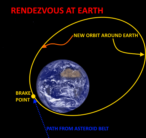

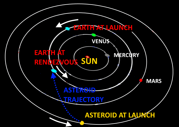

Back again about another issue with my superman expy WIP—a human is transformed into a Superman expy with the four basic powers. Flight, invulnerable, super strength, super speed.
For whatever reasons (mainly to enrich himself), he decides to maneuver a Manhattan-sized asteroid, made of iron and various metals worth trillions, from its orbit in the asteroid belt into Earth orbit. Call NASA for particulars, right?
Only, he wants to stay secret, stealthy, so that’s out. So he decides to “push” the rock out of orbit into a intersecting vector that takes it directly to Earth orbit, any orbit around earth, whereupon he’ll work from there. He goes through these steps:
1.He has estimates for his total power; top end for each “shove”. He estimates distance (~200 billion kms); wants travel time of 3 months. So he can calc number of shoves/pushes to get 3 trillion tonnes of Ni-Fe asteroid moving fast enough
2.Shove how? On what trajectory? You ask. Well, if he’s doing it, it all has to be rough as hell, with him doing mid-course corrections on the long trip.
He makes a small model of the asteroid to guess where the center of gravity is. Therefore he can push through the center on a line where he guesstimates where the Earth will be in 3 months and minimize tumbling of the big iron.
Flies out to the ‘roid. From this perspective, all the planets are in a plane, surrounding him in all directions. Spots the earth. Since its orbit is counterclockwise from above, he guesses--where it will be three months later.
Diagram of the Solar System viewed from above showing elliptical orbits of Mercury, Venus, Earth and Mars around the Sun, with an asteroid's orbit at lower left and a blue dotted vector line from the asteroid to Earth's position at rendezvous.
Aims at that point through the CG and gets behind the asteroid.
Shoves his calced number of shoves to get it up to speed (maybe 25 km/sec?). The way I figure the rock will then have a hyperbolic trajectory, curving as it passes the sun and its gravitational influence. He then let's it go, returning every couple of weeks to fine tune.
The last few hours he rides it in, pushing and shoving constantly to avoid collision until he gets roughly 500km from the earth--
Diagram titled RENDEZVOUS AT EARTH showing Earth with a yellow elliptical new orbit, a labeled BRAKE POINT on the orbit's lower left, and a blue dotted path from the asteroid belt arriving at that point.
He jumps in front, pushes/brakes a calculated number of shoves to slow it down to say 7 km/s where it will swing into orbit around the earth. Always staying with the planetoid to avert a somewhat cataclysmic collision, eh?:wink:
With regard to orbital mechanics, what have I messed up?

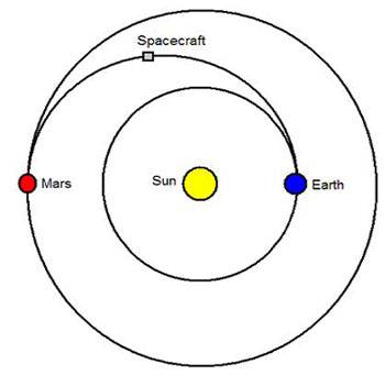

Your diagram shows a straight vector of the asteroid from launch to rendezvous.
This will not happen.
The asteroid is already moving around the Sun on its own orbit. Supe will not cancel that motion in order to send it to Earth, he'll use it.
Transfer orbits - especially if one wants to conserve energy - look more like this. They are a long spirals from one orbit to the next:
Diagram of a transfer orbit: a spacecraft on an elliptical path from a Mars orbit to an Earth orbit, with the Sun at the centre of two concentric circular orbits.
I'm not sure how this asteroid - which is going to very obviously be under artificial control - is going to be moved stealthily.
He might get it moving toward Earth without anyone noticing, but they're sure going to notice as it gets within a few hundred thouand miles, and they'll defintiely sit up when it artificially brakes upon reaching Earth rendendezvous.

True, I knew I overlooked something in that drawing. That transfer orbit is very clever, but due to plot contrivances the superguy needs to get the ‘roid in Earth orbit in no more than 3 months. Those orbits have windows, correct? And it may be months before one opens, plus months of travel times, AIUI.
So he wants a direct (brachistrocrone?) path. Here’s a path I should have put up-
Diagram of the inner solar system showing the Sun at centre with orbits of Mercury, Venus, Earth and Mars. Labels mark Earth at launch and Earth at rendezvous, and a blue dotted asteroid vector runs from the asteroid at launch to the Earth at rendezvous point.
Three months, length ~250 million kms, means he launches it to a velocity of 30-35 km/s; plus a few klicks more because the asteroid is moving in more or less the opposite direction. At the end the Earth is moving at <30 klicks toward him, more or less. So he gains time there.
I think its velocity is greater than solar escape even as he nears the sun’s neighborhood from the belt, so it would follow a hyperbolic curve, yes? If he launches it well ahead of earth’s rendezvous point the sun’s gravity should curve the rock over to meet the Earth itself. It’s just rough at first, he can return for mid-course corrections!

Diagram of the solar system with the Sun at centre and orbits of Mercury, Venus, Earth and Mars. Labels mark Earth at launch and Earth at rendezvous, and a blue dotted asteroid trajectory runs from the asteroid's launch point to the rendezvous point.
Much of the trip, the Earth would be moving toward him, yes? He could use that to cut down on the velocity? Although on rendezvous he would have to brake harder, so that could be a wash.
Diagram of the inner solar system with orbits of Mercury, Venus, Earth and Mars around the Sun, with a blue dotted asteroid vector curving from an asteroid at launch on the outer orbit to Earth at rendezvous.

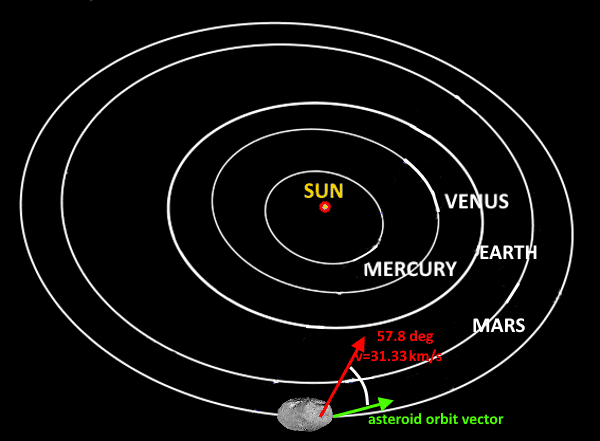

I'm wondering why you have him placing it into a retrograde orbit. That seems an unnecessary waste of effort.
Let's consider an asteroid at the midpoint of the belt (about 2.5 AU orbital radius). If I wanted to get it to Earth is under ninety days, I would alter its trajectory into a hyperbolic one with Earth orbit at perihelion. An trajectory with an eccentricity of 1.75 will do the trick as it will take just under 90 days to travel from the asteroid's orbital distance to the Earth's orbital distance along that track. As long as you time it so that the Earth is at the perihelion point of this trajectory at the same time as the asteroids arrives, you are good.
From my figures, it works out that you would have to change the trajectory of the asteroid by an angle of 57.8 degrees and give it a velocity of 37 km/sec.
If this final trajectory is prograde, then this means you need to apply a delta v of 31.33 km/sec. When it arrives at the Earth it will be moving at ~49.4 km/sec, so in order to to put it into orbit, you will need to kill most of the difference between that and the Earth's orbital velocity.
If you try to put it into a retrograde orbit, you will need an initial delta v change of 49 km/sec. There will be a ~ 79 km/sec difference in velocity between it and the Earth upon arrival, and it won't get to the Earth any faster.

This seems to be an ideal solution (calcs and all)!
Is there a launch window involved? According to my plot, the entire journey, including waiting for a window, must be 2, to no more than 3 months.

After arriving at the Earth rendezvous, if he slows it to about 7 km/s viewed from the Earth's frame, do you think the orbit will most likely be circular? Or elliptical with a periapsis of several hundred kms?
