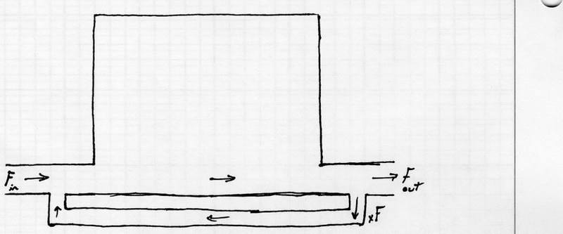

A rigid tank of volume "V" contains salt dissolved in water at a concentration "C". Fresh water flows into the tank at a rate of "F". A fraction "x" of the exit flow is recirculated back into the entrance flow.
Given:
V, Volume of tank
Fin, Flow rate in
Fo, Flow rate out
x, Fraction of volume flow-rate recirculated

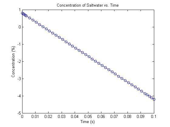

[tex]\frac{dC}{dt}=\text{concentration of salt entering}-\text{concentration of salt leaving}[/tex]
[tex]C_{in}=xFC(t)[/tex]
[tex]C_{out}=(1-x)FC(t)[/tex]
so [tex]\frac{dC}{dt}=xFC(t)-(1-x)FC(t)[/tex]
When I plot this using Euler's Method, I get this graph. This is obviously incorrect, because it does not reflect exponential decay. Can someone help me out? I'm really not sure what I've done wrong.
I may have found my own mistake. I totally forgot to take into account to volume of the tank. I believe this wound change the Flow Out equation to:
[tex] C_{out}=(1-x)FC(t)[/tex]
so the final equation would be:
[tex] \frac{dC}{dt}=xFC(t)-\frac{(1-x)FC(t)}{V}[/tex]
is this correct?

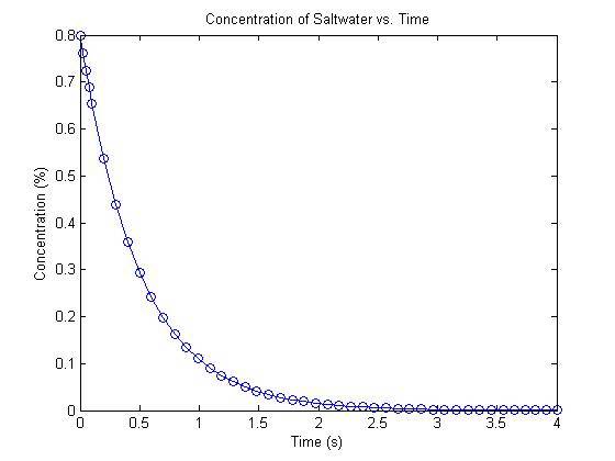

With some randomly chosen values (V=10,000 ft^3/s F=10 ft^3 x=.2 Co=.8) I get this, which seems much more reasonable.
