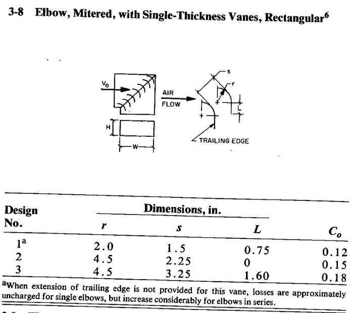

I want to change a fan's airflow direction
I want to change the direction of airflow from a fan. The fan is covering a window so as to bring fresh air into the workspace, exhausting warmer air through open windows throughout the workspace.
It would help cool those in the immediate area of the fan if it were blowing 90 degrees to the current orientation, but in order to draw in fresh air, the fan must remain where it is, covering the window.
I am considering building a simple curved surface (an arc of 90 degrees) sandwiched between 2 flat surfaces. The fan will blow onto this arc and the air will exit the arc, changes by 90 degrees.
For best effectiveness, should this curve be a constant-radius? Or some other shape?
Thank you.
The larger the radius, the less the restriction, and the more air will flow. The following chart, from my 1985 copy of the ASHRAE Handbook of Fundamentals shows the effect of the radius:
The restriction is a function of the Co number - smaller number is less restriction.
If space is tight, you can use a square elbow with turning vanes:
Turning vanes in a square elbow can reduce the restriction to almost the same as a large radius elbow. They give you the option of building a square elbow, installing it, and checking the airflow. If the airflow decreases too much from the fan without the elbow, just add turning vanes.

Thanks for your replies. I’ve decided to use my original design, a simple 36” radius curved surface built with 1/4” plywood. The radius surface will be HDPE.
