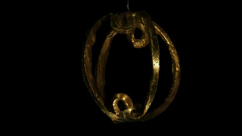

I'm doing an AV about a friend who died 3 years ago. In his spare time he made hundreds of tiny, what he called "Worlds", sculpted out of copper, brass, aluminium, ranging from 1cm to 3cm across, hollow. They don't weigh much. I've set up a rig to film them rotating at 1 RPM. About a dozen of them will be used between chapters in the AV, 10-15 seconds, like a planet filling the screen. See attachment.

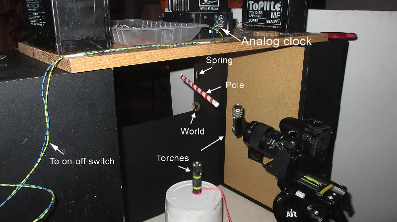

Rig Construction (see attachment)
I attached a thread to the centre of the second hand on an analog clock, from which hangs a spring. I chose the spring so I can easily attach new "Worlds" to the hook at the bottom of the spring. The spring does not act as a spring (as far as I can see).
Each "World" has its own thread, super glued to the top, with a loop at the other end which I connect to the spring's hook. The thread is the thinnest I could find – 0.18mm.
Resonance
The problem is – some of the "Worlds" resonate. They speed up and slow down, some even go into reverse. I thought: "Aha – I'll attach a long pole to the bottom of the spring, to act like those long poles used by high-wire artists. That'll add angular momentum, reduce wobbles, resonance, and generally smooth things out".
I made three "poles" out of thin, 1mm solder, 10, 15 and 20 cm across. I also fitted a straw as part of the testing (see attachment), thinking: this won't add much mass, but a lot of air resistance. But still, if I fit all four 'poles' in turn, there are resonances in some of the "Worlds".
Questions
Q1: Is there some catch-all solution to stopping resonance? Or will I have to tailor each 'pole' to each "World"?
Q2: I wait at least 5 minutes to allow resonances to die down, but some seem to persist. If I wait long enough, will resonance dissipate?
Q3: Any suggestions on other techniques to reduce resonance.

Does the seconds-hand move forward in steps or smoothly? If it moves in steps, that may be exciting the resonance. You will need to dampen the resonance and all higher frequencies. That may be done by changing the length of the fibre, maybe substitute thicker and softer string for the top part.
You could hang the world from a human hair, a Kevlar or carbon fibre, which could be much thinner than the thread.

Just take a simple wind-up mechanism (from a toy or bought separately) and use it to rotate the object on a rigid sick. With a static black background the stick will be trivial to remove from the footage.
Thanks for the responses. A rigid system, string or stick, would reduce resonance but it would be very difficult to make the "World" hang central, as it does when using a string. I reckon you'd see wobbling.
Anyway, my pole idea, while not eliminating resonances, slowed them down so much that I was able to get the required 20 seconds of relatively smooth rotation by filming for 3 minutes and choosing the smoothest section.
I still don't know what an "AV" is, but now I just have to see this video when it's finished.
