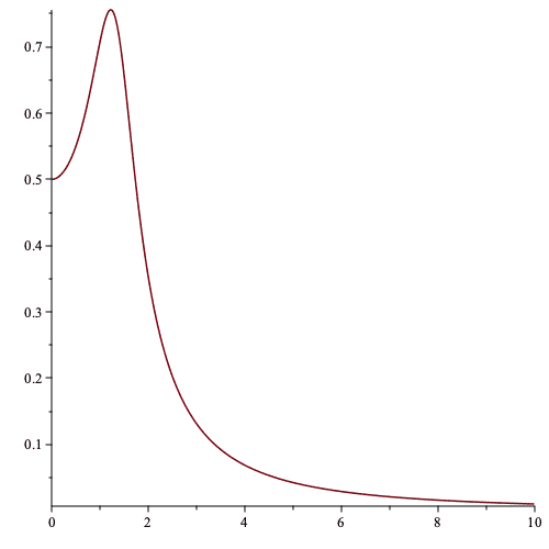

Here is an example of this latter case
$$\ddot{x}+\dot{x}+2x=\cos{(\omega t)}\tag{11}$$
Here is a plot of amplitude as a function of ##\omega##

In practice, I think you'll find lots of different informal usages. IMO, the term resonance applies any time the solution contains complex roots, at least for linear (or linearized) systems. This would include low Q systems that don't appear to be "very resonant", but wouldn't include systems that have frequency peaks constructed of simple poles/zeros, like a bandpass filter for example.
Other people will undoubtedly give you a different definition.

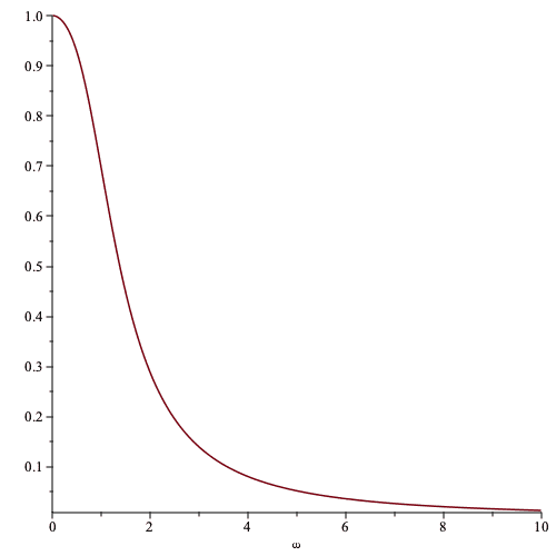

In addition, consider the system
$$\ddot{x}+\sqrt{2}\dot{x}+0.75x=\cos{\omega t}$$
The characteristic polynomial is ##r^2 +\sqrt{2}r+0.75## and the roots are complex.
Here is a plot of the amplitude of the steady-state relative to the input frequency ##\omega##
When ##\omega=0## there is no oscillation so the amplitude is a fixed long-term position that the system is in.
The roots being complex does not seem to be a sufficient condition.

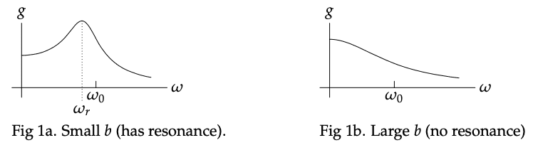

These notes seem to explain what I am getting at in my posts above.
They define more terms, practical resonance frequency and practical resonance.
They say
If the amplitude has a peak at ##\omega_r## then we call this the practical resonance frequency. If the damping ##b## gets too large then, for the system
$$mx''+bx'+kx=B\cos{\omega t}$$
there is no peak and hence no practical resonance.
and
Practical resonance occurs at the frequency ##\omega_r## where the gain has a maximum.
The gain of such a system is
$$g(\omega)=\frac{1}{|p(i\omega)|}=\frac{1}{\sqrt{(k-m\omega^2)^2+b^2\omega^2}}$$
where ##p## is the characteristic polynomial of the differential equation.
The max occurs when the denominator has a minimum.
This happens when
$$\omega_r=\sqrt{\frac{k}{m}-\frac{b^2}{2m^2}}$$
In my original post I found ##\omega_r## by maximizing amplitude, but this is equivalent to maximizing gain, which amounts to minimizing the denominator of gain, and the minimum occurs at a value of ##\omega>0## only when certain conditions are met in addition to the roots being complex.

Why do you want to say the system in Fig 1b is displaying resonance?
It has complex roots but no resonance in the SHM sense of increasing amplitude, and also no maximal amplitude of actual oscillation. The gain is always smaller than ##1##.
