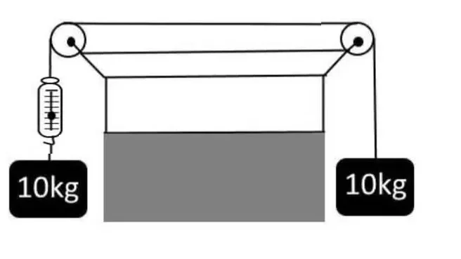

TL;DR
What does the scale read in this diagram?
My learning is a bit rusty. I can intuit the answer but I can't formalize it.
What does the scale read?
I say the scale reads 10kg.

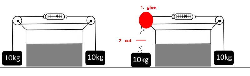

My logic is this:
  1. Fix the left cable and pulley in place with a giant glob of glue.
  2. Cut the cable holding the left weight.
  3. The scale is holding up a 10kg weight. Nothing has changed as far as the scale is concerned.
But what is a more elegant way of getting the answer?

I think you meant to describe it in a different way. If you fix the left pulley and cut the cable at the left weight, the left cable fragment slips over the fixed pulley and the scale is pulled over the right pulley by the right weight. Fixing the left pulley does not constrain the left cable (modulo the low friction between the left cable and the left fixed pulley).
I think you meant something more like "attach the left cable to a wall instead of the pulley and weight... :smile:
Sorry, you're right, what I wrote was ambiguous.
I meant a giant glob of glue that affixes both pulley and cable in place.
russ_watters said:
That's fine, but also: The rope can only have one tension. It can't be 10kg by each weight and 20 in the middle (a common error).
I don't follow. Who says it would be 10kg by each weight?
Since the weight is stationary (i.e., not accelerating), the tension pulling up on the weight must exactly balance the gravitational force pulling down on it.

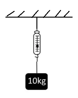

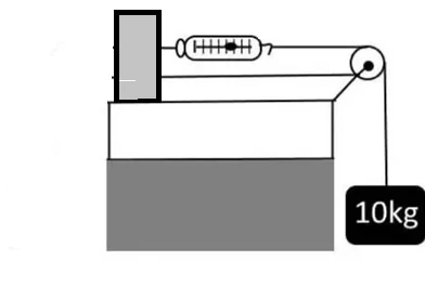

Suppose you eliminate the pulley on the left and tie the cable to a fixed block resting on the table top, as shown in the figure below. What will the scale read?
Next, hang the scale and a 10 kg block from the ceiling, as shown in the figure below. What will the scale read?
Hopefully, you can see that in all cases the tension in the cable is the same.
Yes. That was exactly my logic in the opening post. (Ijust glued the left pulley and cable solid.)

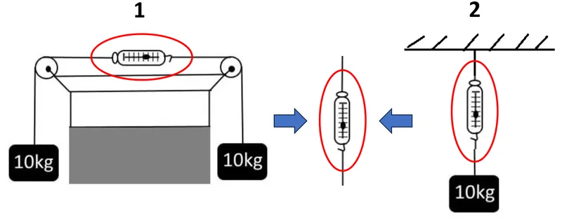

Mister T said:
I don't see it as an alternate explanation.
Once you go through the sequence of scenarios associated with each situation shown in the figures, you conclude that the tension is the same in all three scenarios. It's therefore an error to think the tension doubles in the first scenario.
Right. That's the same as my opening analysis. But it's not elegant because it requires saying "OK, let's look at this alternate layout and now you can see it's the same as the given layout." I would be that is not how it is solved in physics classes.
I have to assume there's more direct explanation, one that simply analyzes the given diagram irecxtly.

DaveC426913 said:
Right. That's the same as my opening analysis. But it's not elegant because it requires saying "OK, let's look at this alternate layout and now you can see it's the same as the given layout." I would be that is not how it is solved in physics classes. I'm not sure that helps me.
It appears in Paul G. Hewitt's famous "Next Time Questions". In the instructor's guide, which accompanies his Conceptual Physics textbook, that is the way he explains the answer.
If you pull on a cable with a force of magnitude ##F## the cable pulls back on you with a force of magnitude ##F##. You can measure this magnitude by inserting a scale between you and the cable. Orient it so that it reads the force exerted by you. Flip it around so that it reads the force exerted by the cable. In both cases the scale reads ##F##, verifying the validity of Newton's Third Law. The value of ##F## is by definition the tension in the cable.

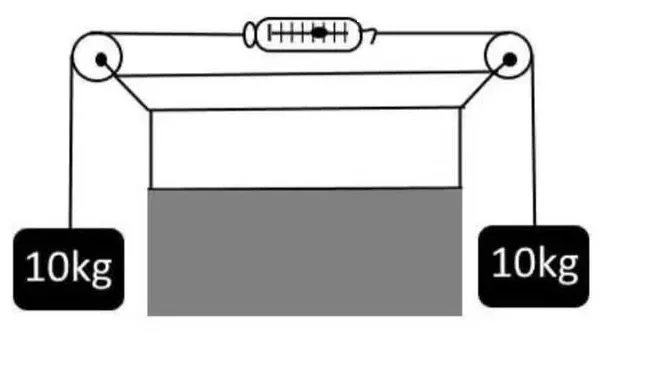

DaveC426913 said:
OK. I see that explains why it's not moving, but that still doesn't really explain why it's 10 and not 20.
Use the Newton meter in its usual configuration hanging from a ceiling, hang a 10kg mass from it and let it settle. In that configuration it has a 100N force pulling it down from the mass. It must also have a 100N force pulling it up from the ceiling attachment, otherwise it would be accelerating by Newton's second law. You want this to read 100N.
In the horizontal case in the OP you have 100N forces on each end, just as in the experiment I described above. So it should read 100N (or 10kg depending how it's calibrated).
Bandersnatch said:
Are you guys pulling my leg? How is that not 20kg in tension?
Did you not read Post #7?
Or, 200N if you want to calibrate it that way!
