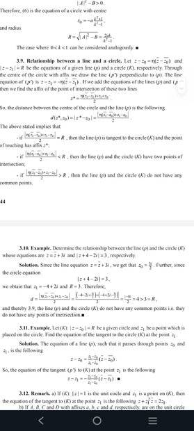

I was reading a book on complex numbers where I stumbled upon this article.
I was following it when I found some error.
Scanned page of a book on complex numbers showing printed equations for the distance between a circle and a line, sections 3.10 and 3.11 with worked examples, and a remark on the unit circle.

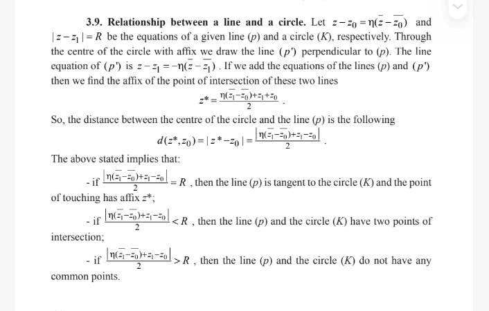

The distance between the center of circle and line should be mod(z star - z1) right?
Z0 is just any random pt on line.

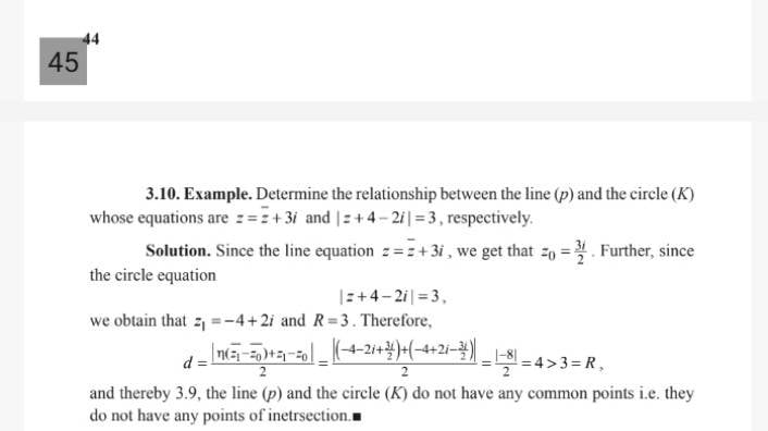

They have continued this fallacy in example 3.10 also.
Am I correct?

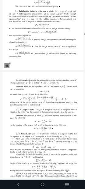

I have added zoomed in images too
Photo of a printed page from a complex analysis book showing sections 3.9 to 3.12 on the relation between a line and a circle in the complex plane, with formulas for distance and tangency conditions.
Printed page showing Example 3.10 on the relationship between a line (p) and a circle (K) in the complex plane, with worked solution computing z0, z1, the distance d and R = 3.
Printed page from a textbook, section 3.9, on the relationship between a line and a circle in the complex plane, with formulas for the intersection point z* and the distance d(z*, z0) and three cases comparing that distance with R.
PeroK said:
The attachments are too small to read.
I've added more zoomed in versions sir
How does the author define ##\bar z##?
PeroK said:
PS if ##\bar z## is the complex conjugate, then the whole thing looks wrong.
Yes and eta is the complex slope
The equation ##z = \bar z + 3i## reduces to ##y = \frac 3 2##, where ##z = x + yi##.
And, the equation ##|z + 4 - 2i| = 3## is the circle radius ##3##, centred on ##-4 + 2i##.
Clearly, that line intersects the circle at two points, as it passes the centre at a distance of ##\frac 1 2##.
PS using this geometric approach, you can see that the point on the line closest to the centre of the circle is ##-4 + \frac 3 2 i##.
The book's conclusion is truly bizarre!
Yes sir....they have used their previously derived eqns using z0 as the center of the circle lol.......Thanks sir I just wanted to verify. And sir can you suggest some books on complex numbers please

It's probably just a typo. For instance, its conclusion would have worked for the line ##z=\bar{z} -3i##. Or the center of the circle could be shifted.
Proof reading a book is an endless, thankless job. You might inform the author of the mistake.

The authors used ##z_1## for the centre of the circle, but when it came to calculate the distance to the centre of the circle, they used ##z_0##.
That's an easy mistake to make. But, if they had checked the answer to example 3.10, they would have spotted the error in that and the formulas in the next section.

I assume this refers to the _shortest_ distance between the two. So you consider a line from the center of the circle that is perpendicular to the line, then find the distance between the center of the circle and point of intersection with the line given. Have you tried this?
Yup the perpendicular dist of line from center.....which they have done wrong in the book.
