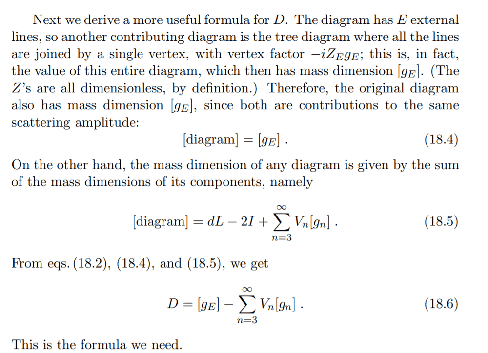

OK, but Srednicki does not present ##D## in any of the above forms. He argues the superficial degree of divergence as follows (he uses as notation ##g_n## instead of ##\lambda_n##).
Based on (18.6) he argues that given any ##[\lambda_n]<0##, our diagram diverges as ##D>0## (where he assumed that the dimension of the tree diagram ##[g_E] > 0## always). So we conclude that any theory with negative coupling constant is non-renormalizable.

1) Why does he assume that the dimension of the tree diagram is ##[g_E] > 0## always? He states that "a theory is nonrenormalizable if any coefficient of any term in the lagrangian has negative mass dimension" but he does so after assuming ##[g_E] > 0##, so I am confused.
