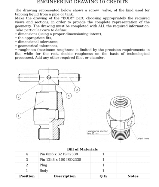

I´m trying to solve the following exercice

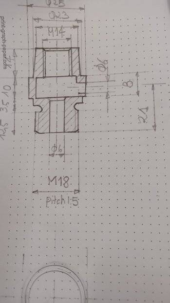

I have done the following drawing for the cross section
and I want to know if I need to add a top view or any other additional view? (is the cross section enough)

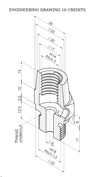

Just imagine that you have to build that body from a chunk of metal.
What dimensions would you need?
Is any of the dimensions shown in the isometric drawing not needed to be included in your side or elevation view?
I believe that I could do it using that single view, as long as the symbol for diameter is properly used where needed, and a note specifying one single lateral hole is added.
