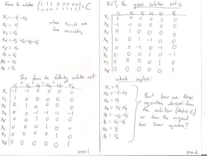

I tried writing out the solution in terms of the six free variables, but my solution set is different thant the one given (sorry for poor pensmanship). I don't understand how the given solution set uses no more than two free varaibles for each of (x1, ..., x8) when x4 depends on 4 other variables.

The two rows in the array represent the equations:
x1+x2+x3=0
x4+x5+x6+x7+x8=0
Solving these for x1 and x4 gives:
x1=-x2-x3
x4=-x5-x6-x7-x8
so
(x1,x2,x3,x4,x5,x6,x7,x8)
=(-x2-x3,x2,x3,-x5-x6-x7-x8,x5,x6,x7,x8)
Now separate that last vector into a sum with each vector having it's own xi factored out.
[Edit] I can't read your attachment at the moment; I hope I have addressed your question.
