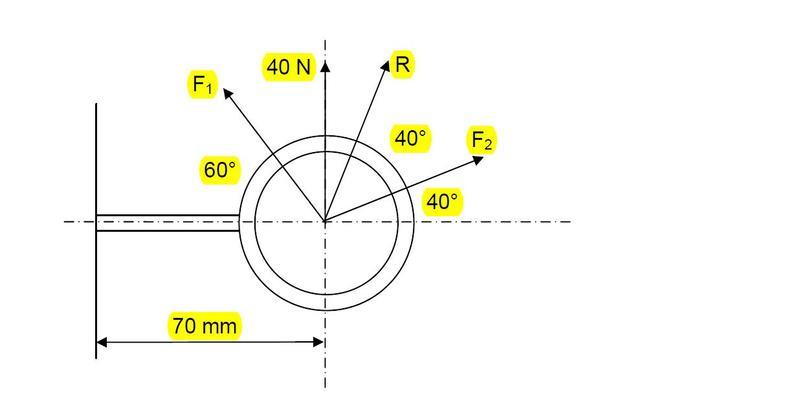

Three forces: F1, F2 and the other with a magnitude of 40 N act on the ring bolt as shown in Fig. C.1. The resultant, R, has a magnitude of R = 180 N and acts at an angle of 80° anti-clockwise from the x-axis. Determine the magnitudes of F1 and F2.
ƩFx
ƩFy
ƩFx=F2*cos(40)-F1cos(60)=180*cos(80)
ƩFy=F1*sin(40)+40+F2*sin(40)=18-*sin(80)
hi mm391! :smile:
ƩFy=F1*sin(60)+40+F2*sin(40)=180*sin(80)
two equations, two unknowns …
eliminate one unknown and solve :wink:​
