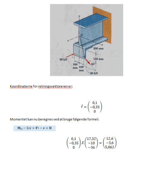

LMW - Dk
I have to determine the resultant R and the moment about O.
see the image.
See the image.

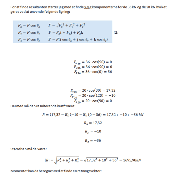

See the pictures. I have found the moment and the resultant. However I think it's the wrong method ^^
sorry, i didn't notice your third picture :redface:
your Fz36 should be minus 36, shouldn't it? :smile:
(btw, i think most people find it easier to use cos and sin, of angles < 90°, and then use common-sense to decide whether its + or -)
i don't understand what you did to find the moment :confused:
can you please type it out in the post?​
Well can't you tell me how you would do this problem? how would you find the resultant and the moment?
If you click on the second picture then you can see that i have drawn a direction vector. Then i have found the cfross product of the direction vector and the resultant force.
ah, now i understand …
no, you've crossed the resultant with the position vector for only one of the vectors: you need to cross each vector with its own position vector, and then add (ie, there's no short-cut)
(and did the minus 36 help?)​
