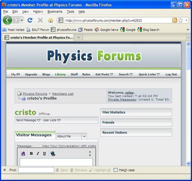

sylas
1,647
On my member's profile page, there is a profile picture, and below that there is a tabbed box for messages, statistics, friends, etc.
On the right hand side of the page, there are three small buttons marked "Mini statistics", "Friends" and "Recent Visitors".
When I first came along, these seemed to have a small click box to expand or unexpand the button and reveal something about, respectively, mini-statistics, friends and recent visitors. I clicked a button to compress the information, and it all folded up away from view as I expected. But now there seems to be no way to make them unfold again, or expand. Should there be a little click point on each of these three buttons to make them expand?
Cheers -- Sylas

I am still not able to expand the mini-statistics, friends, and recent statistics boxes that are over on the right hand side of a profile page...
Cheers -- sylas

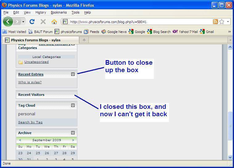

Bump. I've found another instance of the same problem.
I've just recently started using my PF blog, with a single article. I notice that in the blog area, there are all kinds of useful information boxes down the left hand side. For example, I closed up the box "Recent Visitors", and now I would like to open it up again. But I can't; once closed there's no button to open it up again.
Here's an attached image of what I mean:

There are a number of places in PF where there is a box that should be able to be compressed and then expanded again, as you choose. I have found that after compression, there's no button to expand it again. I've now twice lost features that I want to use or access, and I simply can't get at them.
Comments above indicate other people have the same problem. My immediate issues at present:
  • Under my blogs, I cannot see the information box "Recent Visitors". I've compressed it and now I can't get it back. Screen shot above, at msg #9.
  • Under the view member profile window, I have compressed the three boxes for "Mini Statistics", "Friends", and "Recent Visitors", at the right hand side of the screen. Screenshot attached to this post.
Is this fixable? Please?
