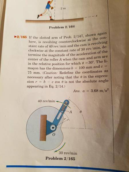

The equation in the picture.
I know I have to use the equation for r but I do not understand how to take of the 40 and 30 rev/min info.
Use the things you are provided however you feel you need to.
Hint: relative motion.

[tex]\dot{ \theta} = \frac{(40-30) \cdot 2 \pi} {60}[/tex]
[tex]\ddot{ \theta} = 0[/tex]
But I think the [itex]\dot{ \theta}[/itex] is wrong.
dirk_mec1 said:
I think the ##\dot{ \theta} ## is wrong
What is the relative rotation rate?
40-30 = 10 revs/min, right?

If two cars approach each other at 50km/h each, would you say that the relative speed is zero because the directions are opposite?
Both given angular velocities are relative to the fixed support. You should define one sense (anticlockwise, say) as positive and express all angles and rotation rates with the right sign.
Let's say CCW is positive then the relative speed is 70 revs/min, is that correct?
Yes.

Unfortunately Simon's hint to use relative motion may have led you astray. You appear to have found the accelerations in the frame of reference of the cam, but that is not an inertial frame.
The cam only affects the radial distance to the roller. Try again, this time using the theta as shown in the diagram, not as a relative angle.
I do not understand how to use the theta as an absolute angle because that is what you mean right?
No, as a varying angle, but only as the angle the arm makes to the horizontal. So the angular velocity is only 40 rev/min. You only need to use the 30 rev/min in calculating r as a function of time.

No, I said you do need to use the rotation of the cam in determining how r varies with time, so it does affect dr/dt.
Let the arm rotate at ω anticlockwise and the cam rotate at ψ clockwise. In polar coordinates, the roller is at (r,θ) at some time t, starting at (r0, θ0).
What are the coordinates of the roller at some later time t?
Using this approach, I get the book answer.
I would say: [itex]r = b - c \cos( \theta + \omega t - \psi t )[/itex]
I defined positive for ω and ψ in opposite directions. You can define positive as the same direction for both if you like, but either way they should reinforce in that expression, i.e. adding up to a rate of 70rpm.
You need θ as a variable, i.e. as one of the coordinates of the roller. The θ in your expression for r is just the initial θ shown in the diagram. You might want to represent that as θ0, say.
And you need an expression for that coordinate. What is that variable θ as a function of time?
