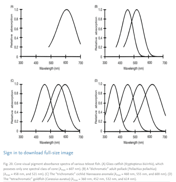

Visual photoreceptors are known to have fairly wide absorption spectra. They can be activated by a range of different wavelength photons. Here are some examples:
The spectra are adjustable. Evolution has selected in different animals for photopigments best suited for their visual environment.
