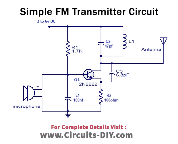

this is the example from which I took inspiration, the doubt came to me when I thought that the speakers are moved by an electrical signal, and the LC mesh acts as a crossover and not as an inductive accumulator, that's why I asked the question

The amplifier is used.
https://www.circuits-diy.com/simple-fm-transmitter-by-using-one-transistor/
The 2n2222 transistor is mounted in a common base amplifier with negative feedback.
C1 puts the base of the transistor to ground for high frequency
C2 brings part of the output signal from the collector of the transistor to the input of the emitter. It is the negative reaction due to the phase shift of the capacitor.
The LC circuit in the collector is the stable emission frequency. It can't be just L without C because it wouldn't have an almost fixed frequency of oscillation.
LC without C would be like a swing trying to swing in the absence of gravity, It doesn't work. Good luck experimenting.
If you used an amplifier with the output in an emission coil, where did you get the audio signal for the amplifier?
the audio player has an RC or quartz or LC oscillator and we still end up with the oscillator
The processor of my laptop that plays music and any audio frequency has a quartz oscillator
