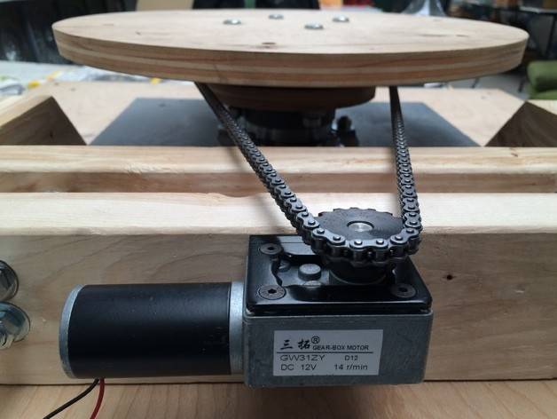

I want to create rotating platform for my satellite dish equipment which weigh around 400kg. I'm wondering what's the best rotator for this? any OTC device, or DIY?
this is the gear box used for that thread
but pretty sure it won't be able to handle 400kg.
this will be used to rotate on regular interval (once every 15-20 mins), and rotate about 3-5 degrees per rotation. if possible, the rotation is accurate to 0.1 degree, and it also needs to have a "locking" mechanism, meaning, once the rotation is complete, it should be immovable (affected by wind blowing, etc). This will be placed on 4th floor, where wind can be quite strong, especially during rainy seasons.
what's the best recommendation when considering the following factors (sorted on priority):
1. least energy consumption since this is used regularly
2. durability (wear and tear)
3. price
low RPM is fine, as low as 1/6 RPM is fine.
thanks

ok, but what about the best mechanism (worm gear, pneumatic, etc) when considering the best overall value of:
1. durability (wear and tear)
2. energy consumption cost
3. price

1. durability (wear and tear).
That will depend on environment. Keep electronics and position sensors out of the sun, rain, bird and insect attack. Use small DC electric motors, avoid hydraulic or pneumatic. Gears on slightly opposed AZ motors should be able to be driven backwards against each other through the driven circumference.
2. energy consumption cost.
Minimum operating costs will be with two small electric motors independently driving the AZ circumference. A reduction gear driven, self locking, screw drive will do best for restricted terrestrial EL. Do not use a ball screw for EL or you will have to keep fighting sag due to mass balance or wind pressure.
3. price.
Start using 600 steps per turn shaft encoders for axis angles. They are cheap at $15 from China. Search; 600P/R Photoelectric Incremental Rotary Encoder. Try to avoid driving a mass through supporting shafts that pass through bearings. Instead, dedicate support pins or shafts to measure direction without drive torque, drive the mass through large radius circle circumference by using peripheral belts or friction drive to save on gearbox costs.

what about worm drive? is it resistant to wear and tear (teeth breaking, worm getting dull, grease, friction, etc)?
for DC motor, any recommendations?
For AZ, a motor driven threaded rod could run on the periphery of a large wooden disk. Over time the thread will press a pattern into the wood. But it would be higher friction and not have sufficient sensitivity to counter wind forces.
Worm gears are expensive, have small diameter output shafts and tend to be heavy or inefficient. You need a drive system that will not be broken by a wind gust.
Your skills at fabrication and the availability of parts will decide your choice of the solution. All I can do is give you a guide to a geometry that will get it going. You can always improve it later to optimise the design.

lets say the moment inertia of the disk plus load is 3600 kgm2, and I only need angular accel of 0.5 degrees/s2. does this mean a 32 Nm torque motor will get the job done? is torque output the only thing I need to look out for when buying the motor?
