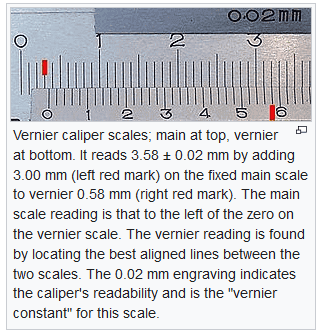

flintstones said:
I teach high school and am trying to put together a resource that teaches students how to measure lengths properly with a ruler or meter stick.
So as part of that instruction, you will cover parallax (already mentioned), and you may want to discuss the use of a Vernier scale to improve the resolution of the measurement. :smile:
https://en.wikipedia.org/wiki/Vernier_scale

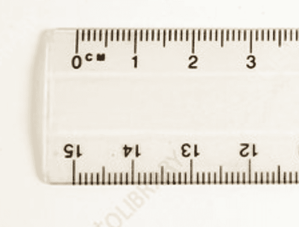

berkeman said:
A better alternative is to use the line for the 1cm (or 1 whatever) mark as the start of the measurement, and just subtract that 1cm from the final length measurement.
Or use a ruler like this one:
