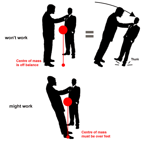

Well boo. Thread got erased out from under me.
Now I have no use for my beautiful illo.

I'm afraid to ask what the tall shadow-guy is actually doing to the short shadow-guy.
Somethings wrong with you Dave. Why would you draw such terrifying art.
What is it?
What does it depict?
EDIT: Oh, I see. The short guy is "in the air". You really should draw a floor in there somewhere.
For a brief few minutes a thread was posted last night, asking if a strong enough person could actually lift another person by their neck at arm's length.
One argument was that, if the guy was strong enough (a la Terminator) there's no reason it couldn't be done.
My argument was, even if they were strong enough, it couldn't happen the way it does in movies. No matter how string the lifter, they cannot do it without shifting their weight so as to put their feet directly below the centre of mass. They'd have to lean back significantly, or they'd have to put one foot out between the other guy's legs. And you never see them do this.

i think it depends heavily on the relative size of the two. and the length of the feet.
True, but I think your drawing exaggerates the amount of leaning the big person has to do.
If the big guy is a sumo wrestler (265 kg) and he's holding Twiggy by the neck (40 kg), then the combined center of mass is only about 10 cm away from the sumo wrestler's center of mass. Assuming the sumo wrestler has an average shoulder height of about 1.4 m, then the sumo wrestler only has to lean back at about a 4 degree angle.
Of course, using a sumo wrestler and Twiggy probably exaggerates the situation as badly as your drawings do, but it also ignores the fact that the big guy's center of mass will be very close to being above his heels, allowing him to counter at least some of the torque of an off-centered center of mass with his feet. If the center of mass has to raise up for the sumo wrestler's body to rotate, then he can maintain his balance, so the combined center of mass doesn't have to be directly above the front of his heels.
You are forgetting the fact that this is a problem about dynamics not statics, unless the lifter is wants to hold the liftee in mid air for a long time.

You're talking about a completely different scenario. There's no question that a very strong person can pick up another person and put them on a shelf.
I'm talking about when they literally lift them straight off their feet and hold them there, toes dangling, thus:
Of course it does.That' s the point of illustrating a concept.
