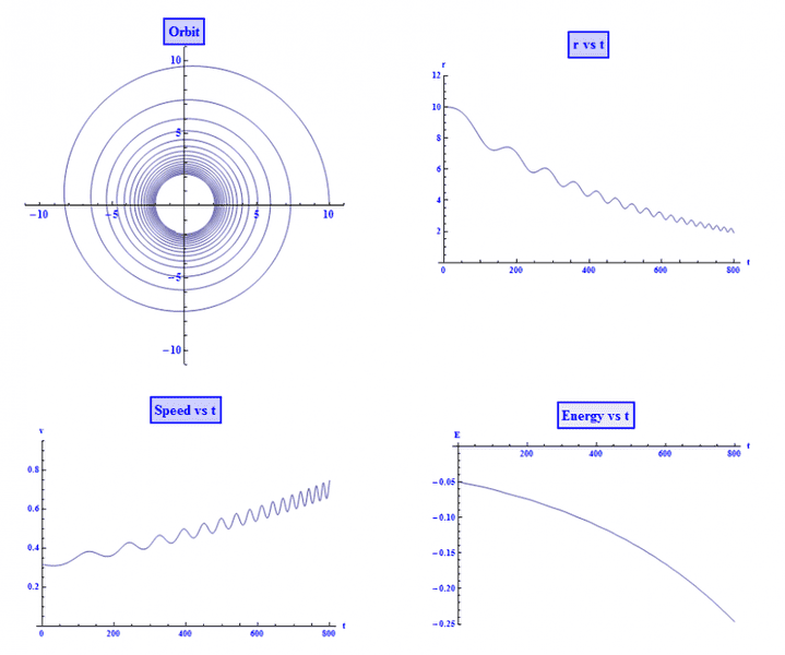

Yes, basically I think that's correct. At least "on the average" the friction will cause the radius to decrease and the speed to increase.

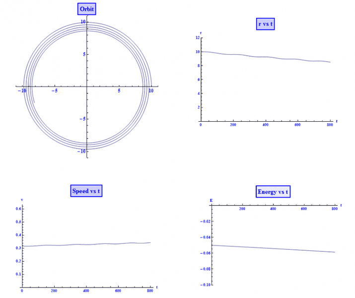

I plotted some orbits assuming a friction force that is opposite to the velocity direction and proportional to the speed. Hope I don't have a bug in the program. The first image shows plots for a relatively small amount of friction. The second shows plots for a larger amount of friction. The speed increases on the average and the radial distance, r, decreases on the average. But you can see that the speed can actually decrease at times and r can increase at times. But the energy is always decreasing.
