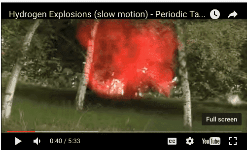

Not sure if it's possible with your 'future' camera, but Prof Poliakoff and I are curious why exploding hydrogen balloons look red.
My idea: put a diffraction grating thingy on your camera, and determine the temperatures.
mfb said:
Looks more yellow to me.
It might have been the "blink" factor, that threw his color scale off.
Screenshot of a YouTube video player titled Hydrogen Explosions (slow motion) - Periodic Table, showing a large red fireball erupting between birch trees over grass at 0:40 of 5:33.
Looks red to me.

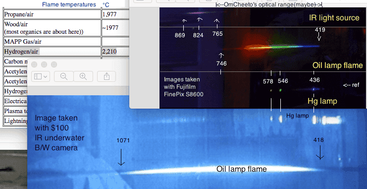

I did a bunch of experiments yesterday, and based on the results, have decided to rescind my request.
The results of my experiments, in visual form:
Composite spectrum photo with a top panel showing a visible-light spectrum of an oil lamp flame with labeled wavelengths 869, 824, 765, 746, 578, 546, 436 and 419, and a lower infrared image of an oil lamp flame with labels 1071 and 418 and a Hg lamp.
Anyways, I'll try and think up some more "hi-speed" experiments.
