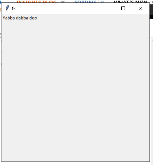

TL;DR
Using PIL and win32gui in order to capture tkinter window as image, then save to file. It's always off-center, and I haven't a clue why.

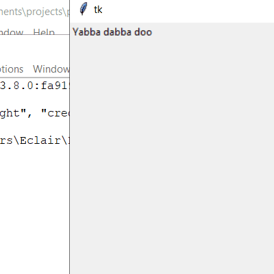

how is it off center? horizontally or vertically or both?
It was both.
The actual window looks like this:
but the saved image looks like this:
In any case, I resolved the issue (partially) by using pyscreenshot.grab and manually tinkering with the capture dimensions. It was not efficient, I confess, but it did the trick alright

Could it be that the screenshot you captured included more than just that one text window? If you manually capture a screenshot of that window, and then paste it into, say, Paint or other graphics app, do you get just that single window or do you get more?
Some documentation I found here says this. Note the last sentence.
PIL.ImageGrab.grab(bbox=None, include_layered_windows=False, all_screens=False, xdisplay=None)
Take a snapshot of the screen. The pixels inside the bounding box are returned as an “RGBA” on macOS, or an “RGB” image otherwise. If the bounding box is omitted, the entire screen is copied.
